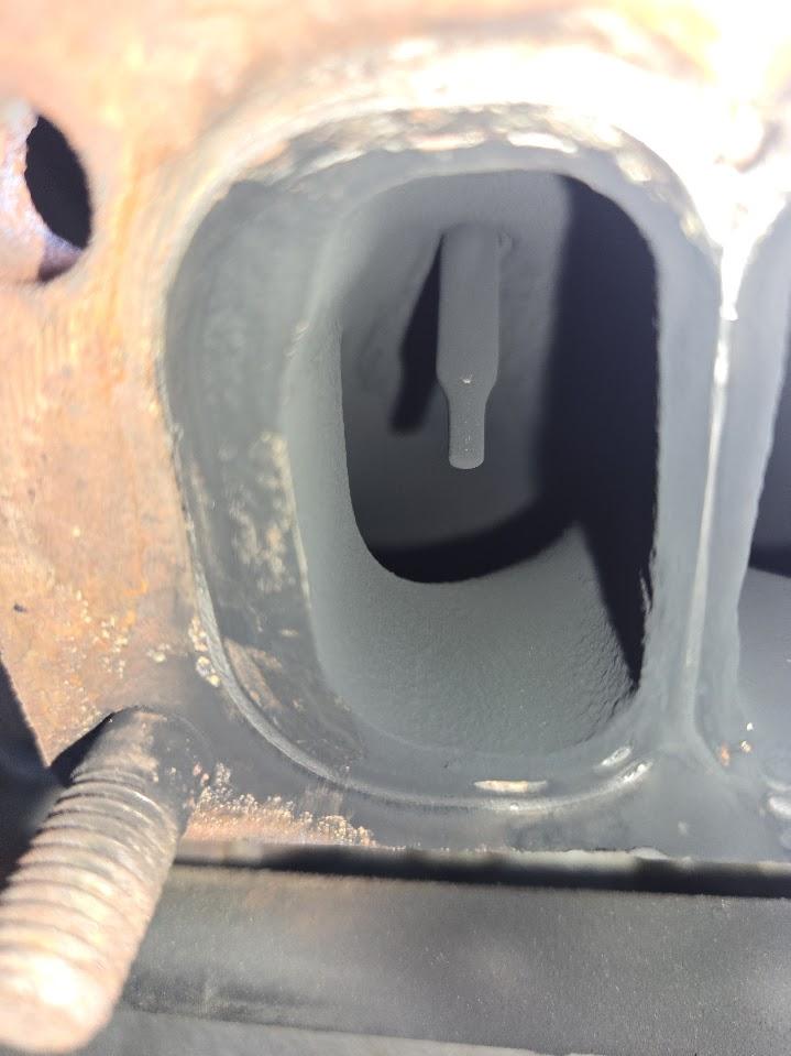

after sitting on it and obsessing. I am going to go on and pull the Holset completely off and see if I have carbon at the exit of the exhaust manifold to the mate of the turbo.. I mean I'm literally at two bolts and and oil drain... I don't know how hot it has to be to turn liquid oil into the carbon covering the exhaust side of the turbo.... so MAYBE it could still be the turbo slowly leaking oil versus dumping oil out the exhaust. if the truck side of the exhaust manifold is sooty... then it has to be coming from inside the engine...at which point I document my oil loss and submit the claim... I just don't see how it would be doing that without blowby showing up or oil being on the ground or coating the entire length of the truck.
Oil will burn off during running. This is why I mention looking after it sat for a night it will leave a wet trace on the valves stem as you look in each port. Intake is bit tricky but if you had a wifi bore scope you could look at each port see if the valve stems are wet with oil.

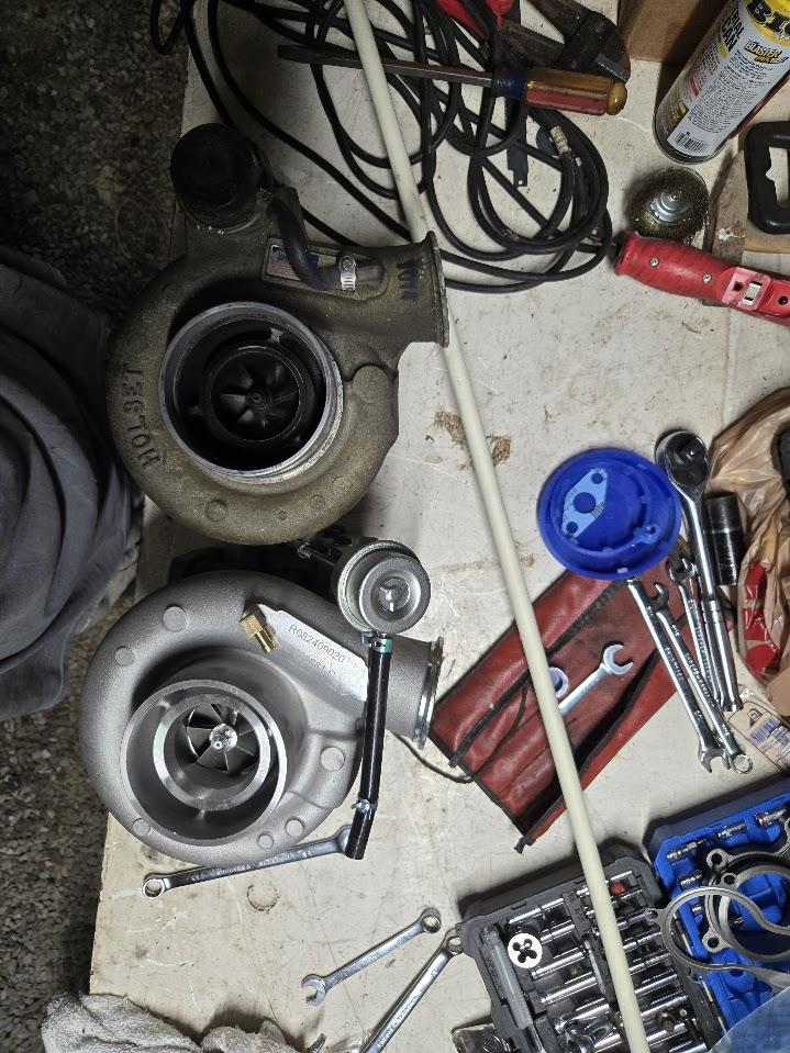

SOOOOO I am now 98% sure that it IS the turbo... I can rub a finger inside of the exhaust housing and VERY little carbon rubs off... but rub a finger in the tail housing and a noxious substance covers my finger and is hard to get off. Problem now is I have to put my old turbo back onto the truck, the A-Premium turbo can't be clocked far enough left because they have a rigid bracket NOT on the turbo housing holding it.. that bracket can not be moved. Last thing, while I have the whole turbo out, what do I need to order for the drain, it looks like just a piece of rubber hose... but it is oily so I'm replacing it. Suggestions on where to get a good reman turbo? right now I'm looking at Thoroughbred Diesel, they have a ROTOMASTER reman for $545 with a core, only problem is a 5 day lead time to get it.
I just uploaded the service manual for the HX35/40 Holset turbo... I used it for likely trouble shooting my turbo... though ultimately I couldn't get my turbo apart to look at the one item that I questioned... didn't want to damage mine which is going back as a CORE... I hate it... otherwise it is still quite tight for a 450k mile turbo... I think my failure was Piston Ring Seal, Turbine (number 13 on the schematic). Guessing that the soot from the break in period is what got me... Replacing my turbo with this one from Thoroughbred diesel. Was the best price/quality I could find. https://www.thoroughbreddiesel.com/h8350108r/

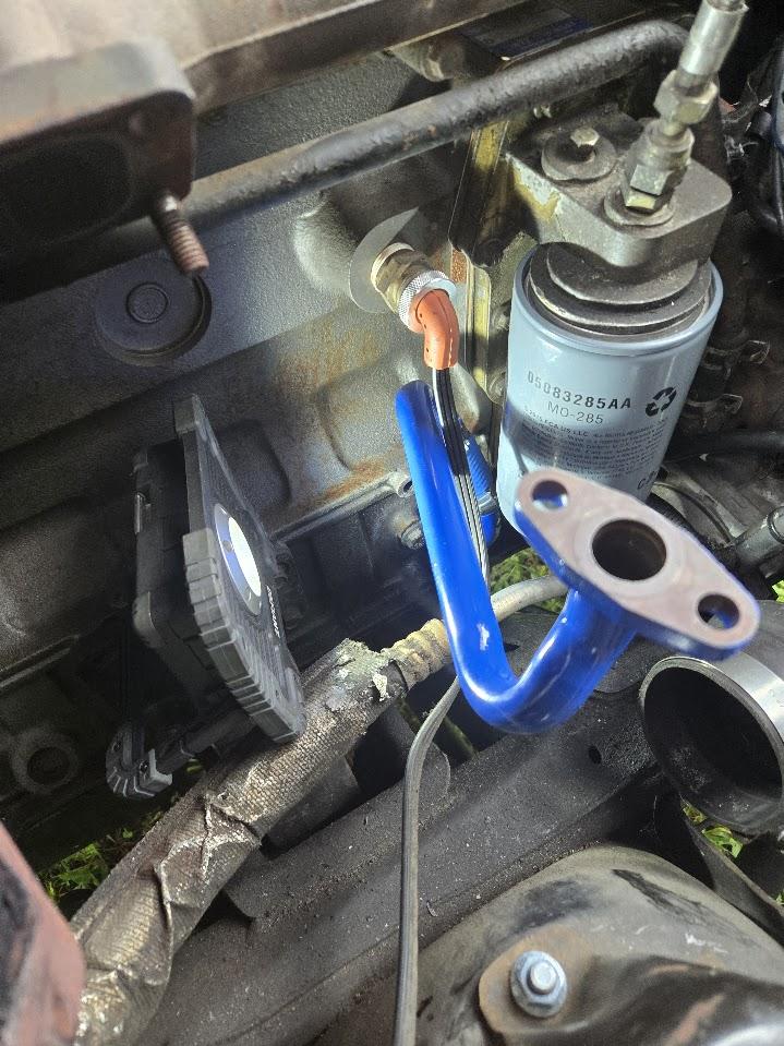

Some additional information, it definitely was heater hose 7/8" OR 22 mm I.D. I actually ordered a foot from amazon because I wanted to replace the oily section... not sure why it was oily but I took it ALL out cleaned it up and painting it all flat black.

:) I actually ordered blue silicone... 22mm I.D. as well as painted several metal components blue. After I got the hose off, it appeared to be silicone jacketed with something rubber, orange interior.... Reman RotoMaster HX35w should be delivered on Friday. Should be back up and running by end of day Saturday.... then the testing starts all over with hopefully NO oil consumption.
  • Solution

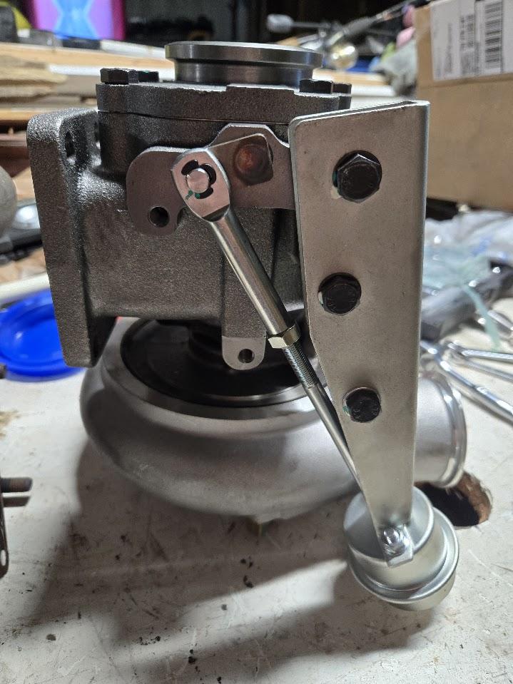

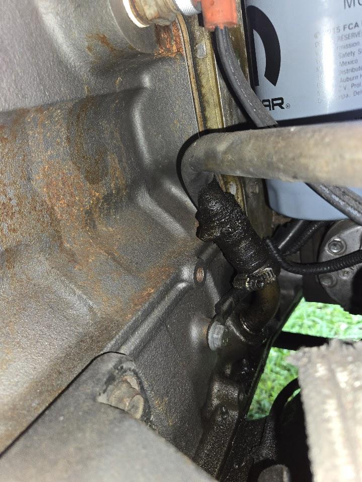

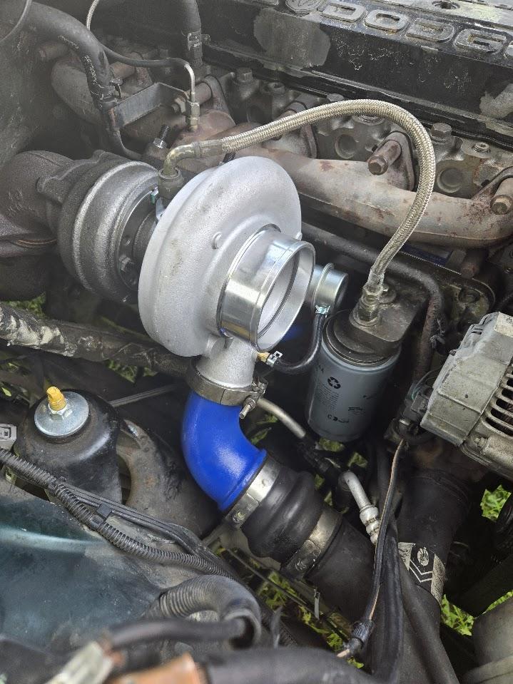

SO... new turbo installed, apparently (only a 100 miles in) I no longer am losing oil. A few things to note... NO ONE knows what the "w" is for on the HX35w, I"m calling it "W" for WING... because the HX35 has a bracket for the waste gate which won't work on our trucks... the true "W" does. After I ordered my Rotomaster Reman Stock Turbo 99-02 I did find some actual "W" turbos for less... but considering I had to send mine back for a core $560 was not bad...just knowing it was all American... $250 and not sending my core in would have been nice, I could have rebuilt it myself and had a backup for when the Chinesium turbo failed.... I did paint some items to match. Here are the photos. One of which was the OLD oil drain into the crank case... I THOUGHT the wastegate tubing was going to come in blue... so I'll replace it later. IT BLEW BLACK smoke the first 10 miles, I am pretty sure that was just getting rid of the soot that had built up in the tail pipe.. because after it ran clean.

The photo with the oily return hose - after removing that hose, could you tell if it was causing any restriction to flow?

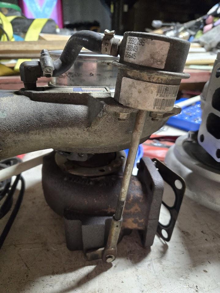

SO... both the HX35 and HX35W have internal wastegates.... I mean in the way I WOULD describe an internal wastegate shown in the photo.... but the HX35W has a "wing" on the outlet housing.... also in photo... and yes I will keep everyone updated on the oil consumption or lack there of.

other than the oil drain at the crankcase being "oily" I did not find any restrictions.... the top side was clean as could be.. even no residual oil from having drained.... I replaced and painted the metal at the bottom side JUST so I could see if there was ever build up again.

:) only 300 miles so not really put it to a test yet.... but I haven't noticed any more peppiness. But you have to remember, my turbo was creating boost... just sending oil along with it.... so I am seeing the same boost levels.... I don't expect much to change minus not consuming oil.
