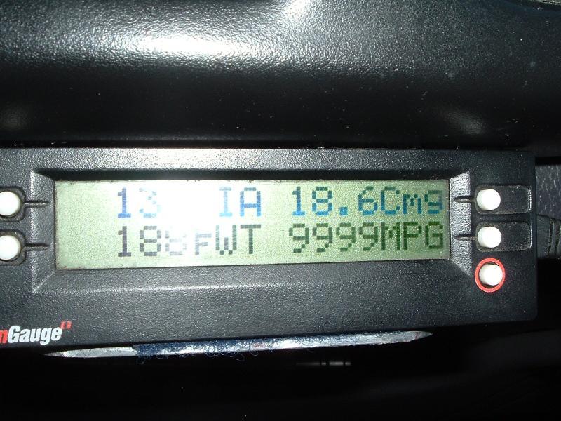

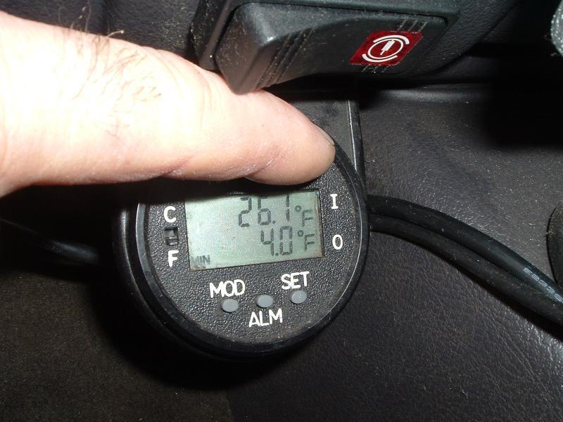

Ok here is todays trip... @ISX yes I've got my heavy Cooper STT's 265/75 R16 on...post-2-138698174163_thumb.jpg With the 2.7K ohm resistor for the trip to McCall ID for shopping... Not bad... I was hoping to smack 20 MPG...post-2-138698174172_thumb.jpg Low record for the trip but on average it was about 19*Fpost-2-138698174155_thumb.jpg Now you got to remember I live at 2,800 feet and McCall, Id tops out at 5,200 feet... So I got climbing, winding roads, reduced speed from snow covered roads, etc...
So you got 18.6MPG going uphill and all that with big tires? What would you normally have got?

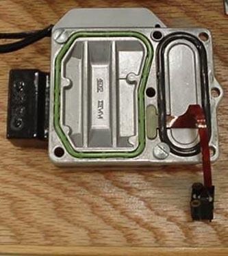

As for the temp sensor in the VP44 its phyiscally attached to the electronics and is part of the speed sensor module... post-2-138698174179_thumb.jpg As you can see there is no way your going to modify that sensor with a ribbon cable inside the VP44...
