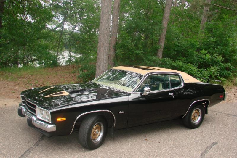

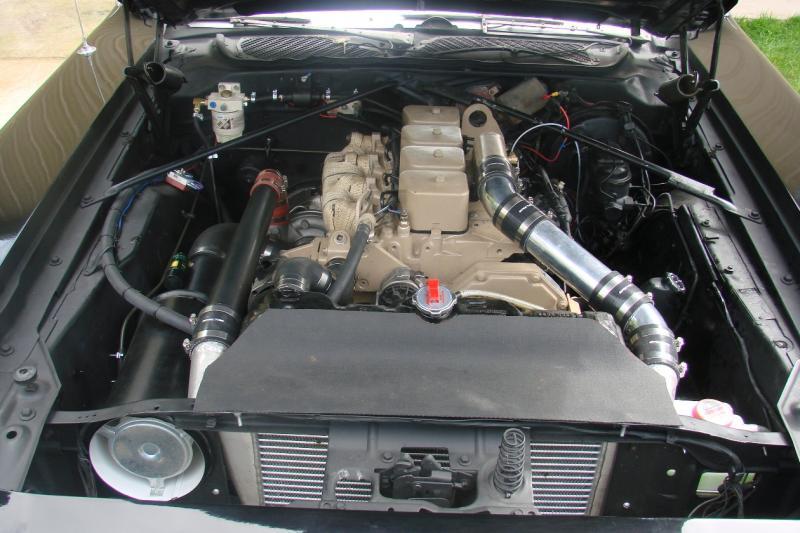

I have no knowledge about the early Cummins engines, but do you have any photos of the install/car?:piwwp:I used to threaten to put a 24V cummins in my barracuda, which always causes my dad to roll his eyes and grumble about the atrocity.

Dudes,Many thanks for the discussion / advice concerning my initial inquiry. Mike, I don't have an exhaust gas pyrometer in the manifold, but do have a boost gauge in the passenger compartment. Would your question be partially founded on the concern that my EGTs might already be a little high? It's probable that I'd need to remove the turbo and maybe even the exhaust manifold in order to install the thermocouple ... correct? Oh and you possess a '73 Charger? Now that's a body style that I'd worship righ up there with the likes of Christie Brinkley and Pamala Anderson!Sir CSM, below you will find the photos of the car and engine compartment. I actually started this project to get my mind off the administrative part of my current job which can be emotionally draining to the point of being depressing. The truth be told, there were a couple moments of this swap where the various challenges were almost overwhelming, but I stuck with it. Do you by chance still have that Barracuda? Damn those are some fine cars as well! To 98whitelightenin, we may actually be speaking about the same individual because the guy I'm working with is named Lee he's a member of the UW-Stout Antique Auto Club that I advise. He did caution me that the engine might haze a little with the 7X10 injectors, but we should give it a try first and then go from there.It's posible that we won't get the injectors into the engine for another month or so, but I'll keep you guys appraised of what comes out of this venture.Many thanks for your feedback,Brianpost-11226-13869817944_thumb.jpg
Very clean install. I have been reading alot of injector stuff lately and majority says go with a 5 hole injector on 12v's. A 5x.014 would be in the same power class as a 7x.010 and I believe the 5 hole has the correct spray angle but this maybe on p-pumped 12v's.
