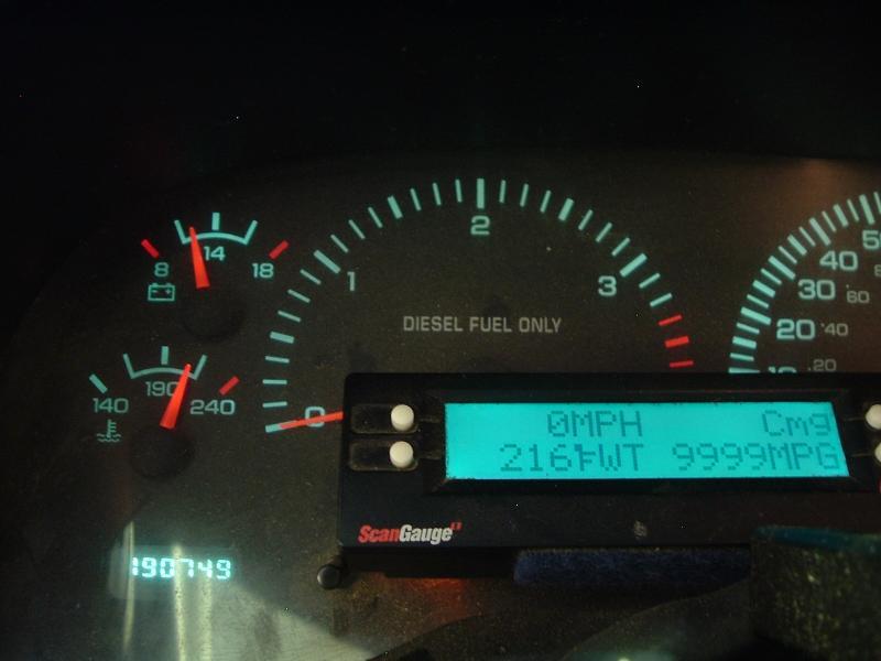

Results are in... I tried using a rheostat and the lower values are easy to hit but the upper value kept doing werid things so I went to resistors and stuffing different resistors into the plug. Tidbit though... I found out the lower the coolant temp the highier the idle is. At 0*F the idle is like 1,100 RPM on its own...:stuned:Lower mark is 165*F...post-2-138698180471_thumb.jpgJust for fun to show 207*F...post-2-138698180479_thumb.jpgUpper limit is going to be 220*Fpost-2-138698180499_thumb.jpg

AAAAAAAAAAAAAAAAHHHHHHHHHHHHHHHH!!!!!!!!!!!!!!!!!!!!!!!! thats about 215.:doh: shoulda listened.
