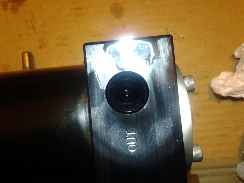

i couldn't find that ball anywhere. not sure if this is right..i reinstalled the same assembly and viewed the output line port, i pressed the plunger which is at the bottom of the reg assembly and it is pretty firm. if there is a ball there it is going to be rock solid. i would think that if there was a ball meant to seat there wouldnt there be a radius of some sort and not just a 90 degree edge. im sure a ball will seal on a sharp edge but the way the plunger perfectly sits on that edge is kinda funny...it seems like it should regulate as is, the pressure should be much less if a ball was meant to be there but it should put out at least 5 psi, right?
post-11059-13869818211_thumb.jpg 1-Outlet Port--------- 2- Regulator assy.---3- Regulator assyCavity---4-Bottom seat-----5- Bottom seat # 2Here are a couple pics. The exterior rim of the Bottom seat presses flat against the machined 90 degree flat. It looks like a ball seats in the bottom seat but let me know what you think.
Is there a possibility there is no check ball in the regulator assembly. It looks like the end of the regulator assembly fits the seat. I could not find an exploded veiw of it at the Pureflow site.
that was my other thought as well...it does fit nicely. i can compress the bottom end in smoothly yet seems firm enough for proper pressure regulation from outlet port.
i installed springs and verified that it compresses smoothly in sleeve using outlet port bore.thanks so much.
so i spoke to pureflo tech just now and before i finished my sentance he asked for my shipping address and said they would ship a viton check ball to replace the current seal which is the "bottom end" in my pics. anyone having trouble with pureflo regulators that have a sleeve style regulator, just call them and get a free viton check ball for better sealing/priming.
