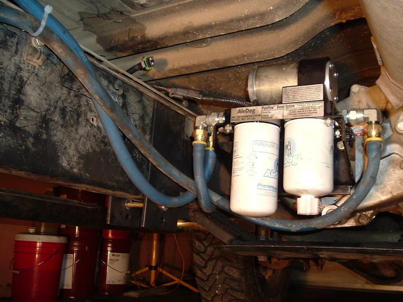

I do have one question regarding the Jiffy Tite quick connections used at the Airdog itself. How far in should those be threaded? The one that was installed by them was threaded in until flush. I stopped on the two I did at about 2/3 of the way. They felt really tight at that point and I didn’t want to strip threads or break anything.
Tight is good but you don't need to be yanking on the wrench too much. The fittings are usually are 18 ft/lbs for the banjo fittings...

Give Eric a call at Vulcan Performance and ask him doe the old school push loc connectors... Looks like the connector on my AirDog. post-2-138698182677_thumb.jpg When Airdog/Raptor switch over to the quick connectors it made installation quicker and easier... But as for making a air tight seal it didn't...
