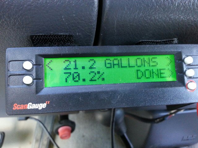

Hey Mike after 3 fill ups in the 12 valve, this is what my offset is for gallons. It doesn't appear to be calibrated correctly. I use the same pump the same location everything.[ATTACH]4424[/ATTACH]From the Galaxy S3
Hey Mike after 3 fill ups in the 12 valve, this is what my offset is for gallons. It doesn't appear to be calibrated correctly. I use the same pump the same location everything. [ATTACH]4424[/ATTACH] From the Galaxy S3
It fine... My 1996 Dodge Ram is 233% offset... That's the beauty of the ScanGauge it will calibrate to any vehicle! :woot: My 2002 Dodge is 22.5%... :whistle:
My 2001 was like 7 percentFrom the Galaxy S3
