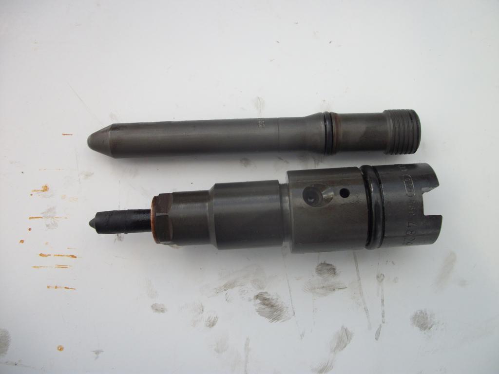

Maybe I should send them to you thracing? I might if this shop does not work out. I am thinking that it will, they say they do a lot of injectors, but of course they are not positive about the CTD. Here are pictures of what I just took out. They go from #1 to #6.post-10349-138698188167_thumb.jpg
