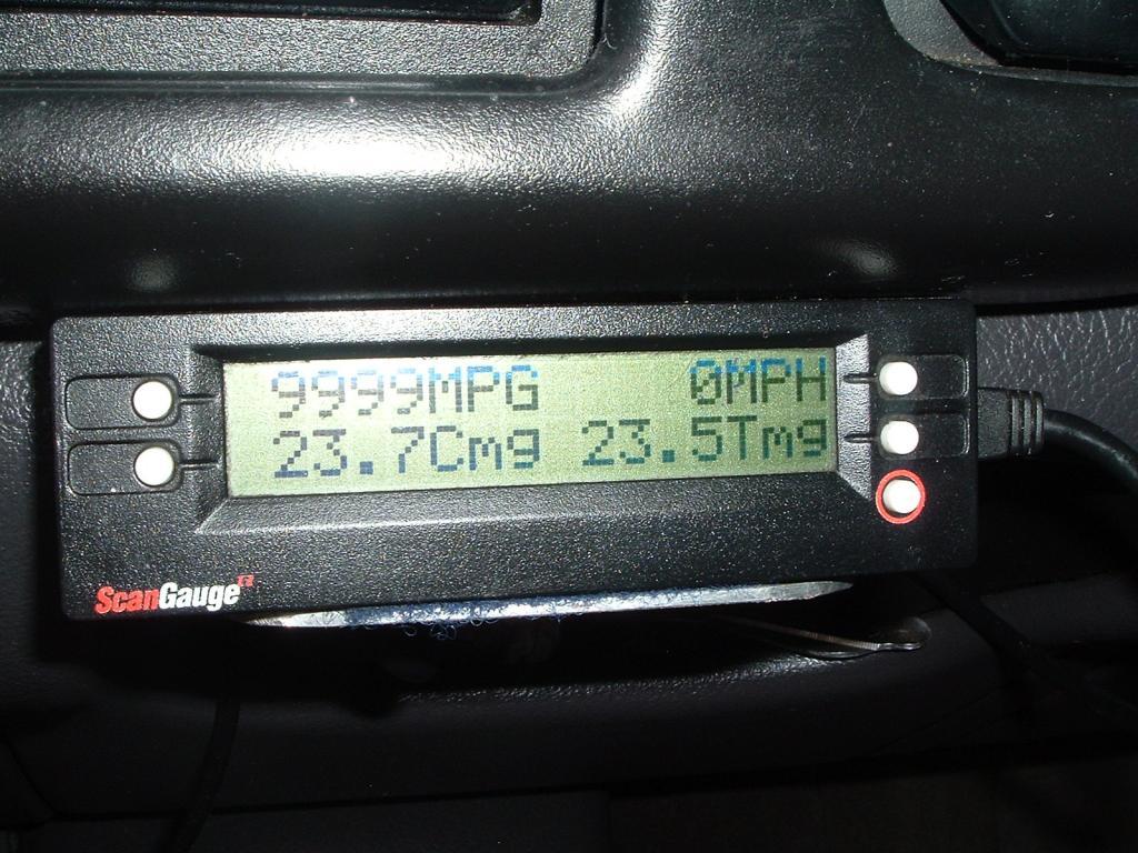

post-2-138698189166_thumb.jpg * AirDog 150 * Edge Comp set to kill (5x5) * BHAF * Straight piped 3" Exhaust * Stock HX35 turbo * IAT fooler set to 143*F * RV275 Injectors The biggest killer is speed the faster you travel the worse it gets... Large tires will degrade MPG's I'm running 235/85 R16
