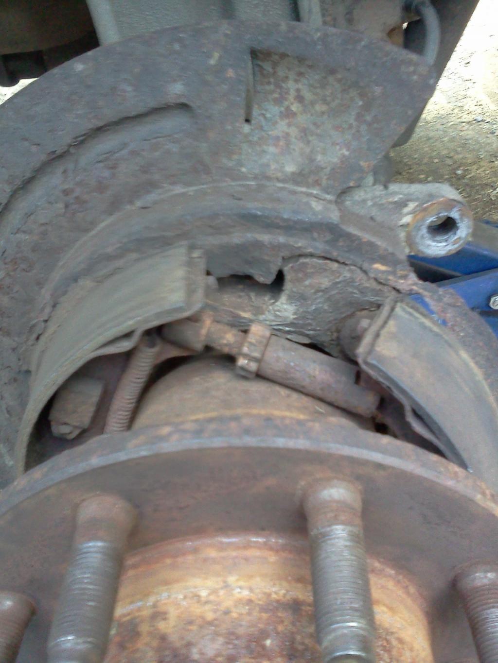

A while back I had my rear drivers side axle out to replace the wheel seal that was leaking and I noticed my backing plate was getting pretty ripe. Kind of said to myself, wonder when i'll have to replace that ? Found out tonight that it's now! :lol: Noticed the emergency brake was going alot further today and wasn't releasing well so I jacked it up tonight to adjust it, but noticed the star wheel for adjusting the shoes was sloppy. Thought I should take the rotor off and look ,and bam, backing plate was rotted off and the one side of the brake shoes let go. Looks like I know what I'll be doing in a couple days when my parts come :banghead:

I wish I lived where rust wasn't an issue too. You can see in the picture where the shoe is laying how there's no support for it anymore
Geez... That is gone... You'll be looking for parts at a wrecking yard.

Wow, thats gonna be expensive.
Ordered my parts today. Direct from Dodge the backing plate and the emergency brake shoes and all the clips extra . comes all assembled and just put it on for $215. Will be here tomorrow. Looks like I know what I'm doing Saturday :lol:

Well, got the backing plate on and all back together, but didn't get the fluid yet. Dealer wants a bit over $20/litre so I'm going to check Walmart before to see if they carry the proper Penzoil that I read can be used. Got a bonus at the dealer when I was there...was looking at a nice Cummins hat that I don't have yet and just asked how much it was out of curiosity. As I was walking out the door the guy threw it and said there you go! :hyper:
