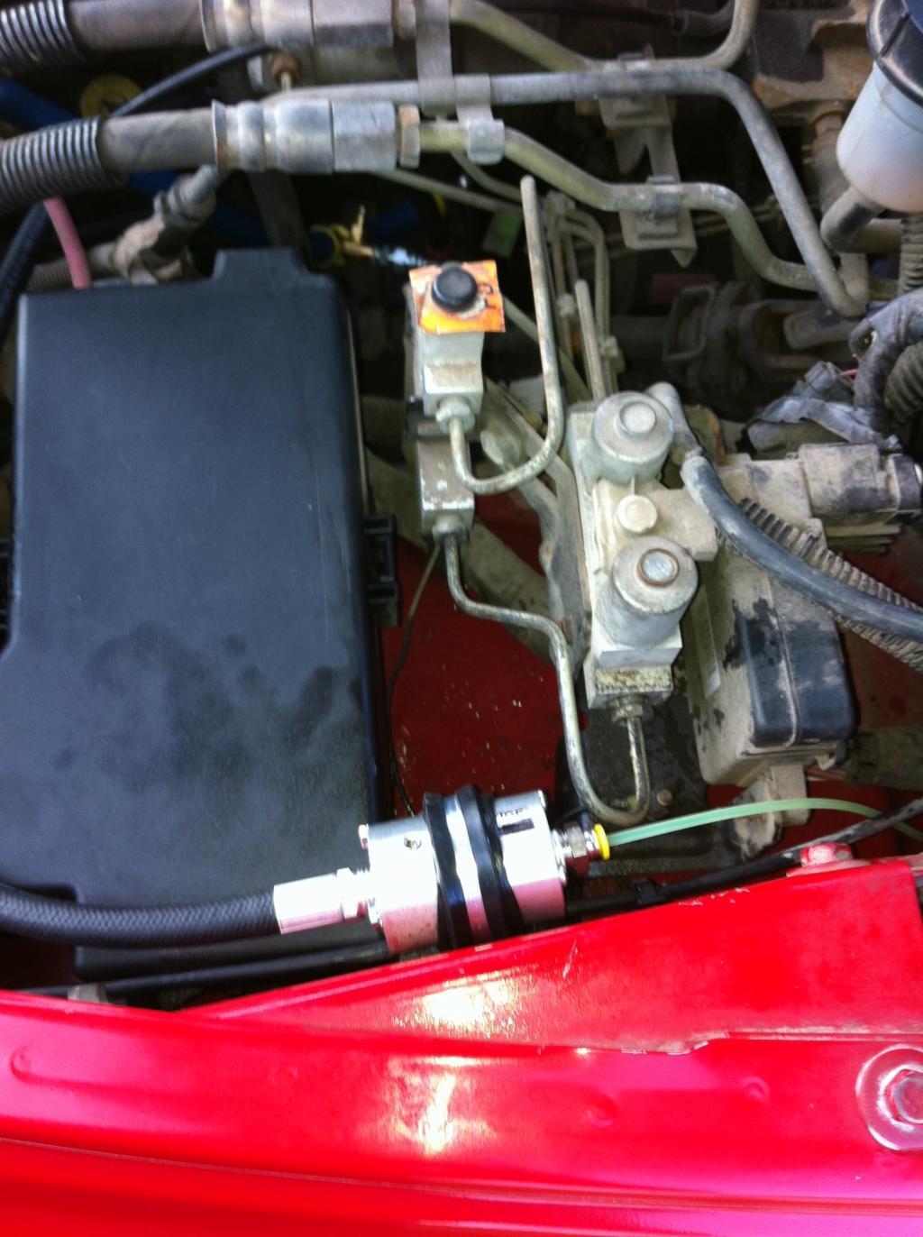

Just installed a ISSPro today in a 2002 Dodge Cummins with a stock fuel system...ISSPro Fuel Pressure Gauge, 1/8" Air Brake Line (rated at 600-800 PSI), WH6820 Needle Valve, Compression Fittings (Male and Female), and Tapped Banjo Boltpost-2-138698190642_thumb.jpg
Nope... A friend on the local fire Dept. I stopped in to check out a performance problem and found a P0216 code. :ahhh: So doing the next step we installed a fuel pressure gauge and so far he's got 15 at Idle not bad but I didn't drive it. So He'll report back his finding by next fire meeting.Katoom you must of not seen the tapped banjo bolt? :whistle:

glad to help.... it came with 1/8 line and im gonna swap it with 1/4 soon as i find the right fittings... i went ahead and mocked it up tonight and when i first started it up...i read 11 psi at idle... then it bled down to zero....while it was running...??? dont know why, but i thought maybe some air still in it....sooo bled the guage line again and got all the air out..put it back together fired it up....reading 5psi at idle..WTH?? not really sure but im gonna upgrade to the bigger line and also pick up a test gauge so i can compare
