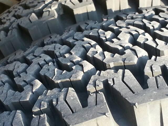

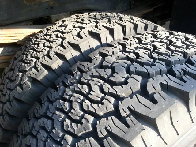

Those look a lot like BFG AT's. On that note the transforce At's are built on a truck casing and can be recapped like the toyo M55. Trying to remember the place down in Chantilly. Alban tire maybe? they used to re-cap a lot of construction tires for me.
