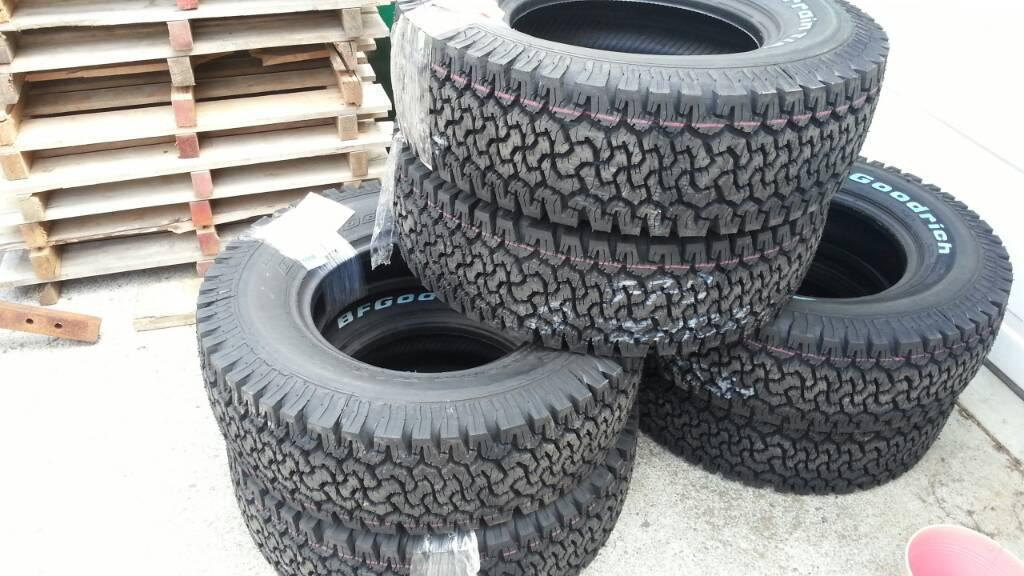

I couldn't find much in the way of "negative" with these. So, I bit the bullet on a set (6) of 245/75-16 Warden A/Ts (E). I'm hoping they'll be here this week. I'll definitely keep you guys posted on how these turn out.
I did not get the B2B style.
The tires ran $90 each, $540 for the set of six, and $144 shipping. Total was $648.48 delivered.
Posted Image

Those look a lot like BFG AT's. On that note the transforce At's are built on a truck casing and can be recapped like the toyo M55. Trying to remember the place down in Chantilly. Alban tire maybe? they used to re-cap a lot of construction tires for me.

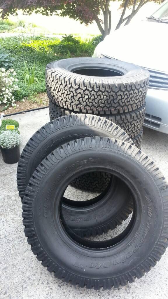

They're BFG T/A KO casings.[ATTACH]5549[/ATTACH][ATTACH]5550[/ATTACH]Sent from my SPH-L710 using Tapatalk 2
Ok wtf. Im here getting them static balanced and it's calling for 13.5oz???? Sent from my SPH-L710 using Tapatalk 2
there are none. Sent from my SPH-L710 using Tapatalk 2
Is this a dot of any kind or just bird crap? If its a dot put it at the valve stem.

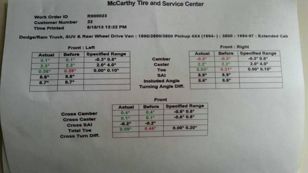

Its a petal from a tree blossom. They eventually got them balanced then aligned the front end. [ATTACH]5555[/ATTACH]Toe was way out. The RF camber is a tad concerning to me. Sent from my SPH-L710 using Tapatalk 2
Apparently some dont put the dot on anymore as its apparently more the wheels fault these days. Who knows. I'm not a tire specialist lol.
Should have told them to crank the caster up to the max, anything under 4 is what causes them to wander, need to get them to 4 or higher even or what ever they can get out of the factory adjuster cams, usually can get up to 4.5 degrees. A good alignment tech should know that they always take the caster to the high side of spec at a minimum, If you look at sports cars and almost all import cars they have a LOT of caster compared to American vehicles.

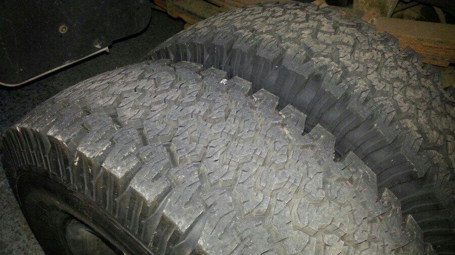

So I towed my 20 ft enclosed at about 5000# gross yesterday. It was one word: squirrelly. Almost uncomfortable. Rears were about 75, fronts were 60-65. Ive since set fronts to 70 and rears to 65. It definitely seems to ride on the centers of the treads. [ATTACH]5608[/ATTACH]Now I dont know if thos it a tire issue, air pressure issue, or a front end issue that reared its head after the alignment. Sent from my SPH-L710 using Tapatalk 4 Beta
What exactly do you mean by squirrelly?I'm not sure which process treadwright uses to retread their tires but my dad got a set of retreads put on the rear of his F-450 that were "cold" retreads and for the first few thousand miles when you took a turn after the tires got warmed up it felt almost like the rear end would start to drift uncontrolled and it was a scary feeling till you got used to it or it goes away.Just looked at treadwrights website and it looks like they used the hot wrap method for retreading which is a whole lot better than the "cold" retreading method.
By squirrely, I mean it that its very unstable feeling, like its on ice almost Sent from my SPH-L710 using Tapatalk 2
Heck. I just got another heavy load of firewood yesterday and had both front and rear axles inflated at 60 PSI the only thing that was squirrelly was the fact the load was so tall that the truck rocked back and forth on highway. Very stable other wise just the center of gravity was way high. Set of 235/85 R16 HighFly's ...:wink:
I have heard similar complaints from friends with Toyos during the first few thousand miles. Those look like pretty deep treads are they a soft compound? Maybe a tad higher pressure next load?
And...?? :think::cool: I I'll give them some more time. As for more air pressure, they're already riding on the center-most 2/3 of the tread, as it is. Wouldn't that just make it 'worse'?
I might have to agree with you on more pressure. If nothing else it would seem to me to wear the centers out prematurely. The photo does appear to show them riding on the center 2/3 of the tread. I am curious as to what you ended up with cost wise. Tires, shipping, mounting and balancing.
