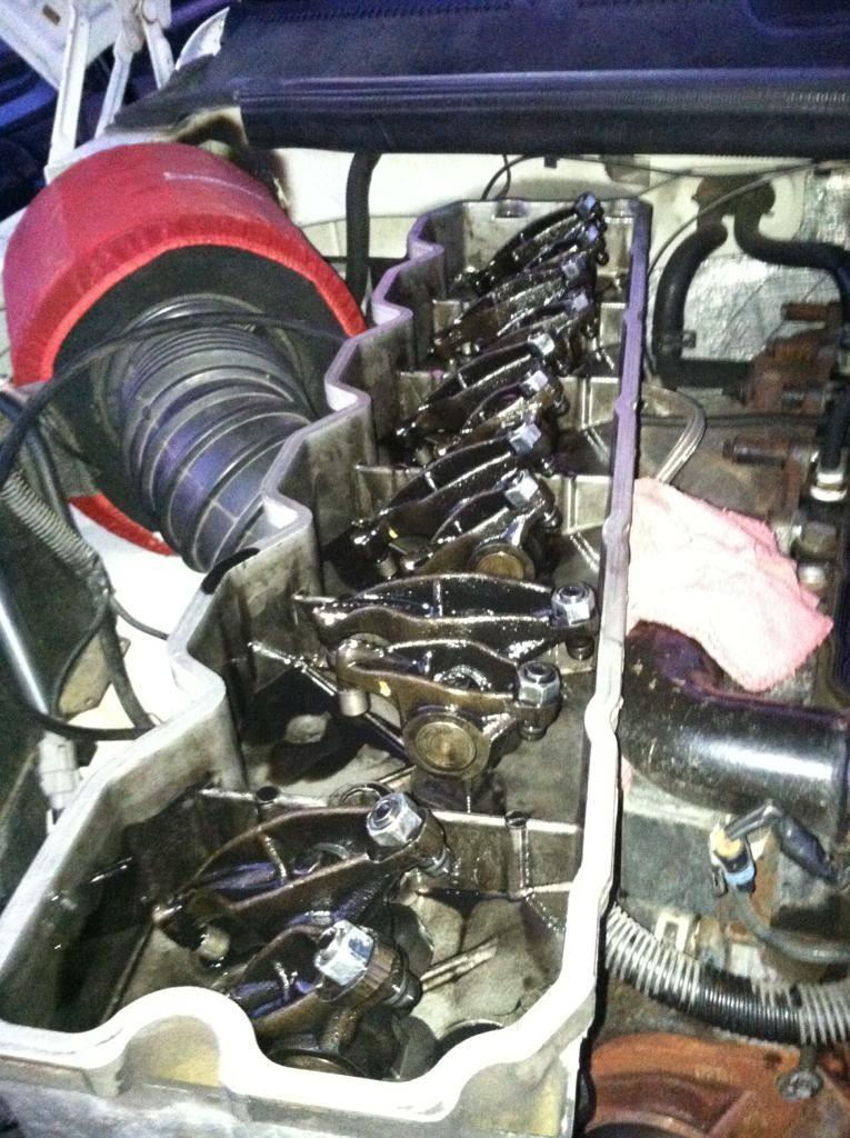

Got a chunk of it done this evening. Pulled the radiator, intercooler, and crossmember off.[ATTACH]5597[/ATTACH]Pulled my balancer and found out why my oil pan is always oily[ATTACH]5598[/ATTACH]After pulling all the bolts holding the gear cover on, I put the balancer back on to set the motor to TDC.[ATTACH]5599[/ATTACH]Next, I pulled the pump nut and gear[ATTACH]5600[/ATTACH][ATTACH]5601[/ATTACH][ATTACH]5602[/ATTACH]My key way would not come out but I rotated it to the top anyway[ATTACH]5603[/ATTACH]Pulled the intake and apps[ATTACH]5604[/ATTACH][ATTACH]5605[/ATTACH]Pulled the valve cover and rockers off, kept them in order so I shouldn't have to adjust the valves when I'm done[ATTACH]5606[/ATTACH][ATTACH]5607[/ATTACH]I put the gear cover and valve cover back on before I came in for the night. I will get out early tomorrow and pull the lines, pump and cam.

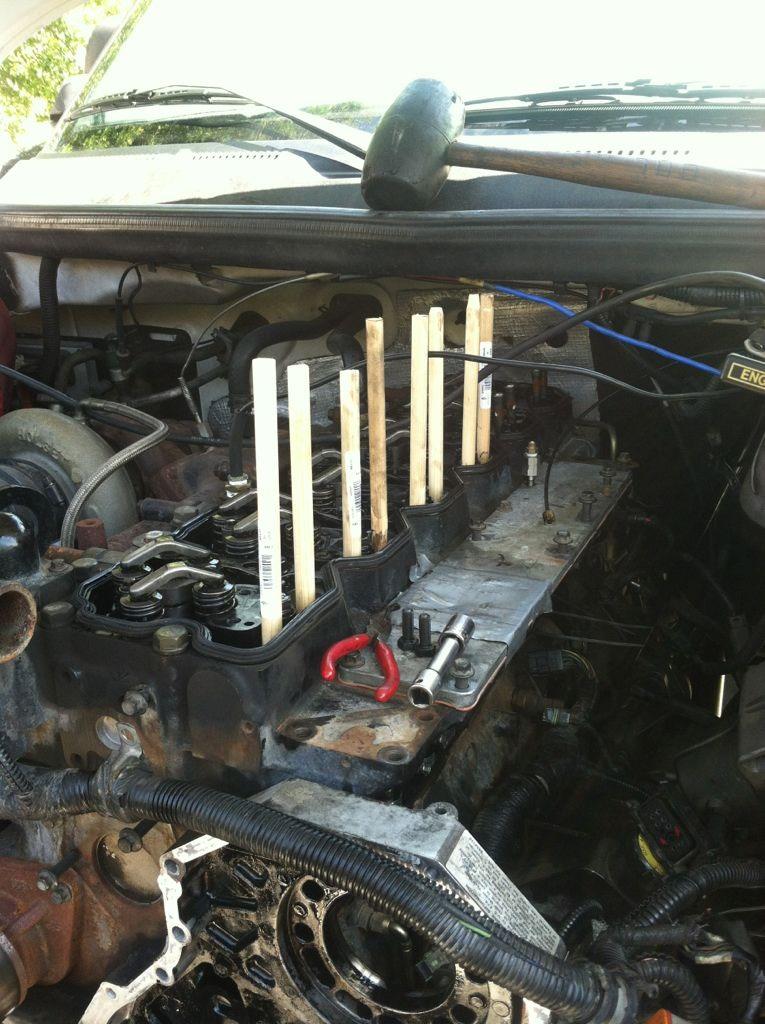

Got some more progress done today. Started at 6:30 this morning and came in about 6:30 this evening, I'm beat!Got some 1/2" dowels and ground the end off to a little point and jabbed them in the tappets, also used small hose clamps/ zip ties to be safe. Dropped the cam holder into the oil pan right off the bat, but was able to recover it with my tiny pen magnet and Jesus on my shoulder[ATTACH]5610[/ATTACH][ATTACH]5611[/ATTACH][ATTACH]5612[/ATTACH][ATTACH]5613[/ATTACH]I worked about 2 hrs scraping the old seal off the block and using my shop vac simultaneously so no junk fell in the pan. Got the p- pump gear housing on and put the cam back in[ATTACH]5614[/ATTACH]Got my rockers and push rods put back in, in the same spot they came out.[ATTACH]5615[/ATTACH] Got the 12v tappet cover on with new sealing washers, also pulled the stock lift pump and put a big block Chevy fuel block off plate over the whole that the stock lp covered.[ATTACH]5616[/ATTACH][ATTACH]5617[/ATTACH]Got the cover put on so no elements get to the insides while I wait on parts[ATTACH]5618[/ATTACH]

Have to pull the cam to get the gear housing that the pump mounts to off. You have to use a 12v housing because the mounting bolts are different between the vp and p7100. I would love to have got a new performance cam but it just was not in the cards now. I'm sure it will smoke more than I want but my vp did that too.
