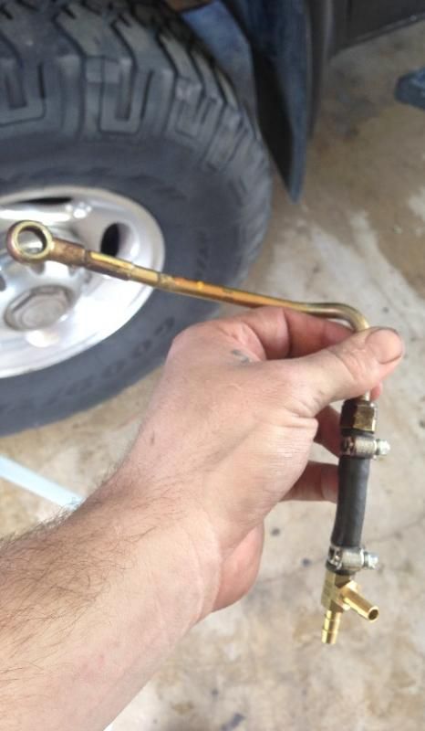

Some of the most common places to leak are the return lines. There is a banjo the comes out of the back of the head (pretty hard to get to) that will leak, as well as the return line tee that is kind of behind the fuel filter housing. Those 2 places are probably the most common places to leak so I would start there. Then I might check the fittings on top of the tank. Did you use a draw straw or something like that?

Try taking the Banjo that comes out of the back of the head out and replacing the sealing washers.

Okay had the chance to get to the return banjo and checked the T as well, both looked in bad shape, banjo not having any "seal" material on inside washer and the Ts' seals torn to shreds, replaced washers on banjo bolt behind head and replaced T completely with a barbed T and a bit of hose and clamps. Although it defiantly needed repairing on those 2 I'm still left with a very hard start. it loves to crank up in the coldish morning but it's off and on every time thereafter. Sometimes easy to start sometimes wont want to at all. What else do yall fellas think it is?
