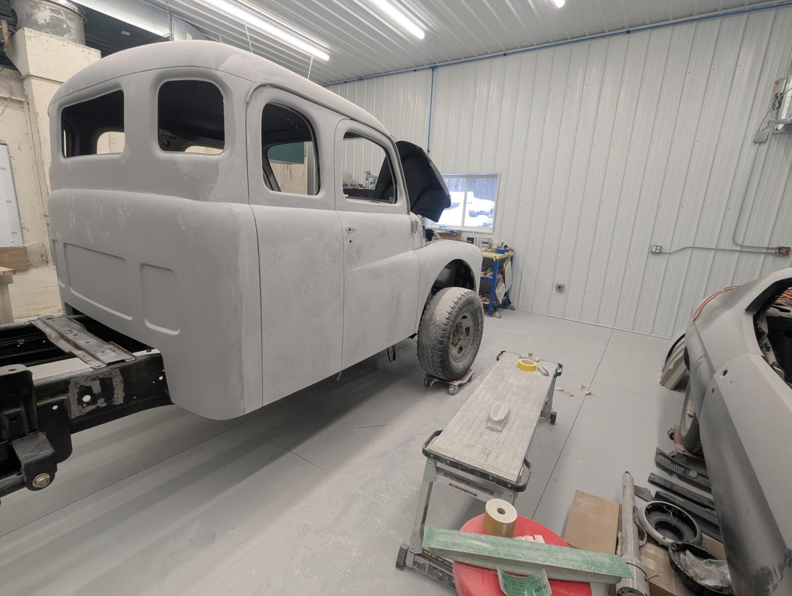

After fighting and fighting to get the passenger door to line up right, I called the neighbor.  He runs his own hot rod shop and has built MANY over the years.  He's been kind enough to help me when I needed for nothing but a beer and a smile.  I think he just likes helping me learn.  Regardless, he came over and we chatted, and we tried, we got the torch out and bent hinges, and tried...and finally came to the conclusion below.  I think he loved the pucker factor I had when I resigned myself to doing the cuts.   Also we will likely work on flattening the top of the window to follow the now long flat section of the roof to make it look more pleasing.

This project is a lot of work, but it is the coolest truck ever. Look at the 3 windows in the rear and quad cab to boot. Best figure on a good security system for it also.
