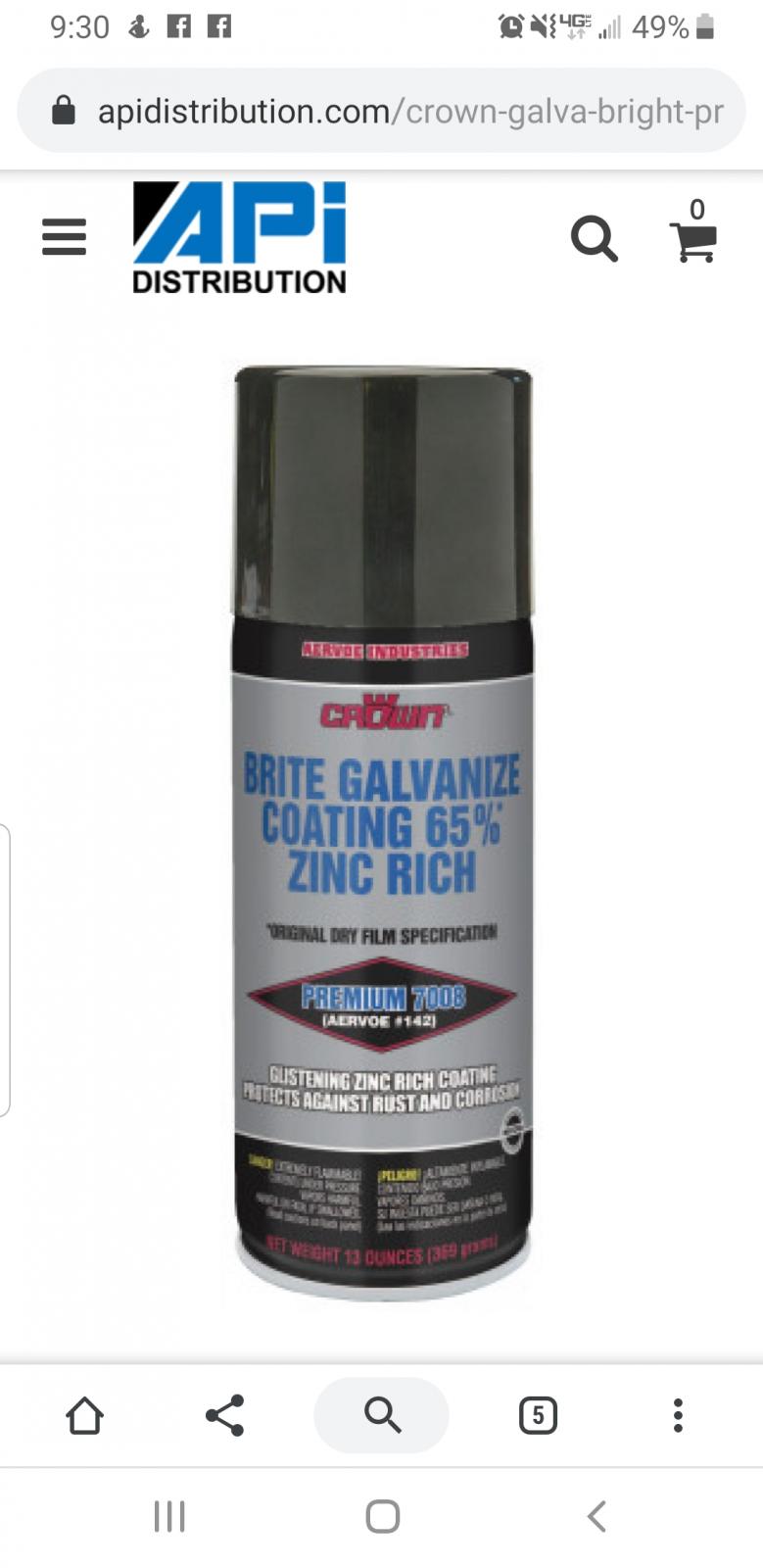

If you ever need a really nice finish that holds up to even light scratches give this stuff a try, its pretty. Awesome stuff. We restore all sorts of small and large mechanisms and the sort, good for hardware finish as well.
We call it Galvabrite.
Really makes a nice finish.
https://www.apidistribution.com/crown-galva-bright-premium-16-oz-aerosol
You can shop around and find it at different places, I get from McMaster Carr.
