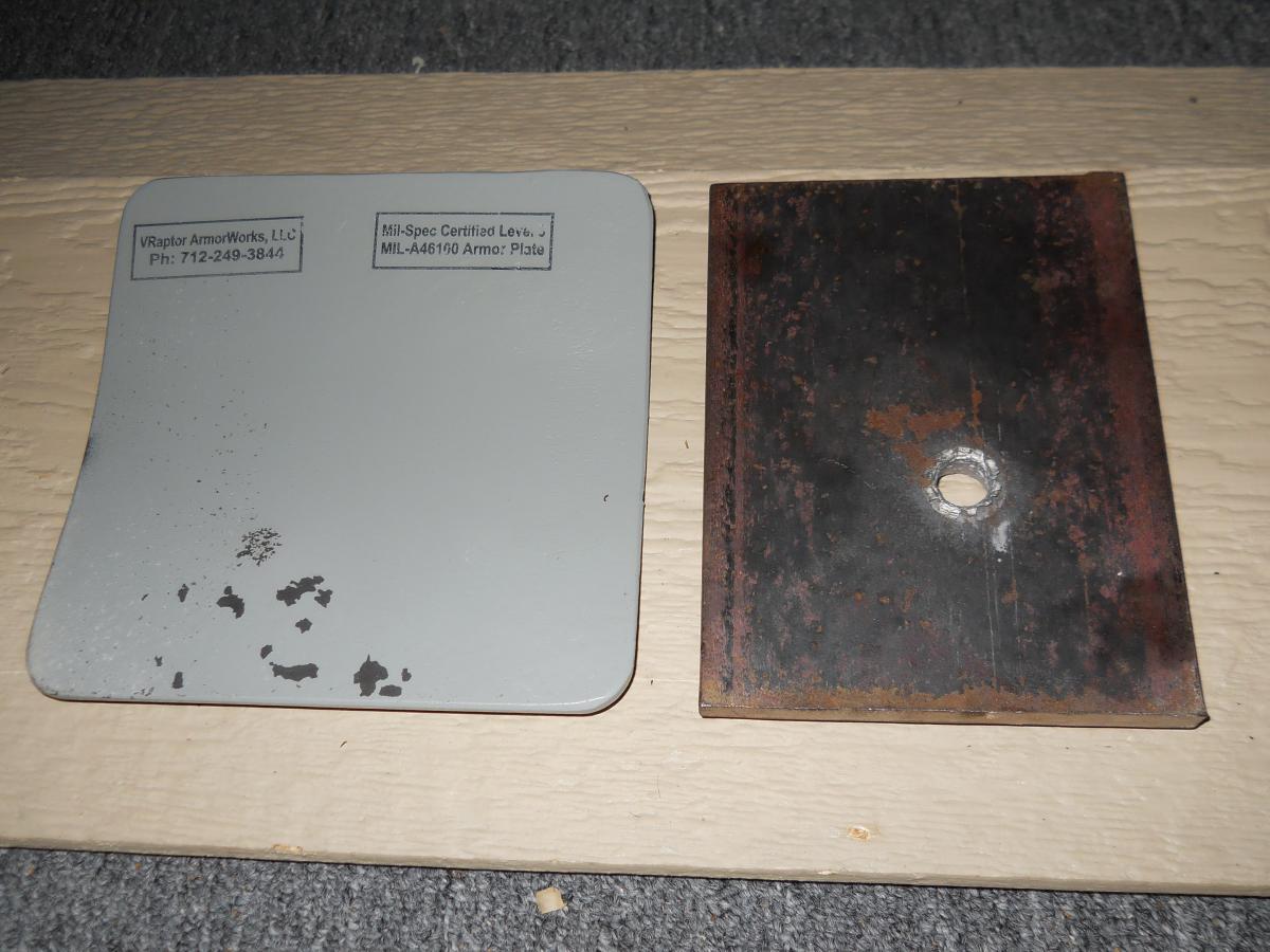

So,   last night,   we    took one of the small   plates  (cheaper to replace)  to  sacrifice   in   a  test  firing.

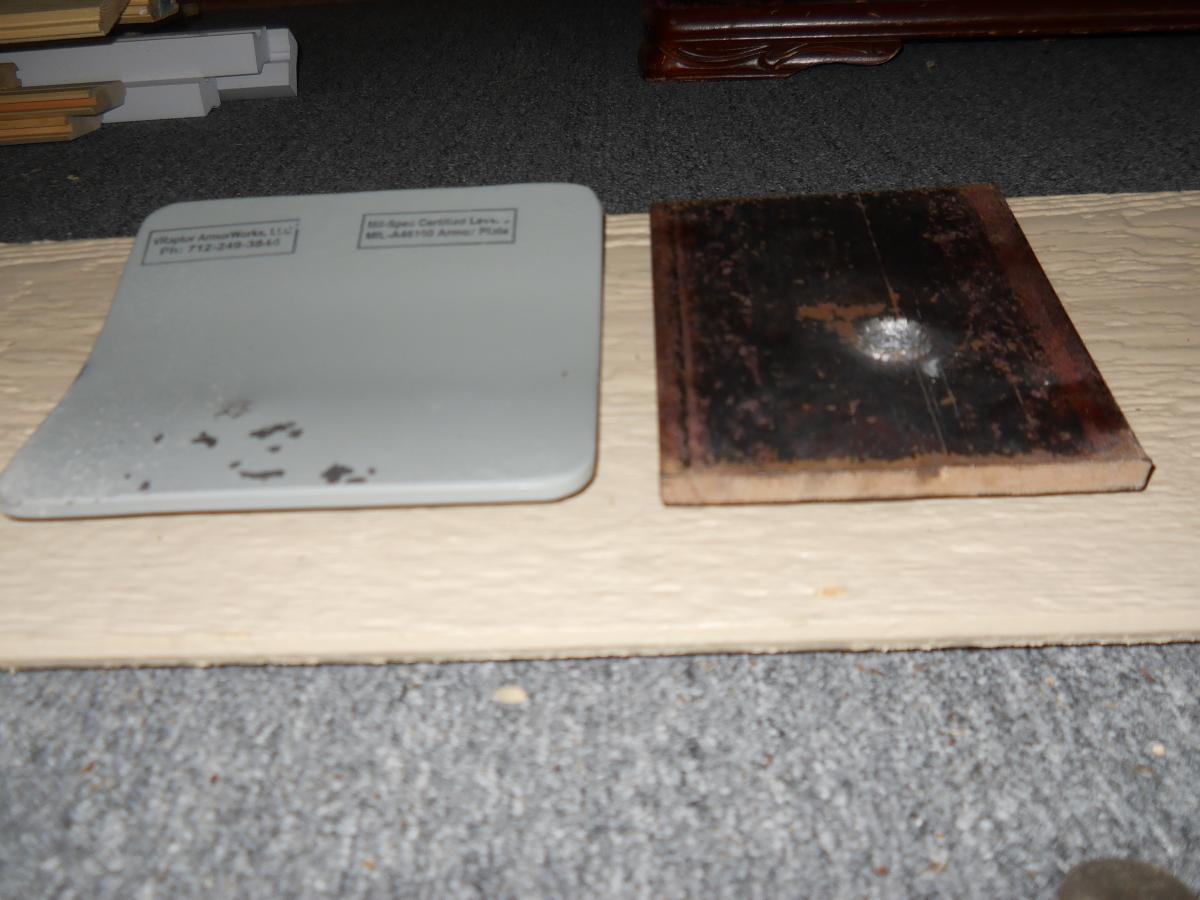

We  also   grabbed  a   scrap of  3/8ths   mild steel  plate  for  comparison...
Test  ammo;     Russian   7.62X54,    220 grain.  Soft tip,   FPS:   2700      Figure    this   round  was going to be  somewhere between a  .308   and  .30-06
Range from  rifle;    about  100 feet

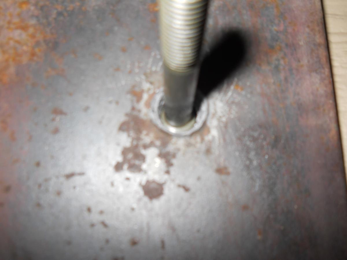

I  put a coin ( quarter) and a  3/8ths  bolt  on the  plate  for  size comparison...     Amazing  the  1/2 inch hole a  .308  bullet  made!        7,62mm  and  .308   is  the  same  diameter

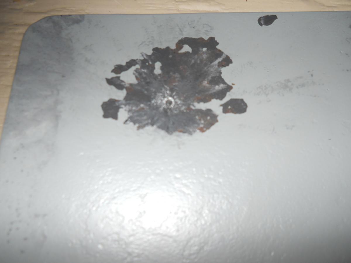

Conclusion:   The test was  successful.      The  armor plating   resisted  puncturing,  it only  showed  a  little  'center punch'  type  ding,  and  the chipped paint!
Granted,    getting hit  with  a  large rifle round  such as  this   (you might  not want to be alive  afterward)   is  going to  knock you end over end...
But for  small  cal   (AK47,  and  pistol)    I  think these would be perfect

LOL<    There  really is no reason to have it, other  than  'having it'.      Conversation piece??
not really  planning  anything,  this  was more of  a  'hoot'..     But  on the other hand,   body armor is still  available to general public. (for now)
All the seller needs to know, is  if  we are a 'bad guy' or not...  (felon)   all  we had to do was  say 'no' to that question!   (and  pay  $160 bucks)
All four  plates  add up to 23#'s    Imagine  wearing that  PLUS  your  pack,  in 120 degree heat!

I would caution you on this type of body armor plate.  Yes INDEED they will stop most non-armor piercing rounds and some of the smaller AP rounds well.
The problem is bullet "spawl" or "spatter".  The bare armor plate may stop the round but the bullet spawl WILL injure if not fatally injure the wearer.
This can easily be avoided by spray coating the plates with a coating of Linex or Rino Liner special compounds designed for absorb bullet spawl and shrapnel.
You can order armor plate sets already treated with a spawl/shrapnel absorbing coating

You will need to spray a layer about 3/8 of an inch thick.  The cost of doing just a few plates may not be economical and buying a set already coated may be the more cost effective route.

yep,  already in 'the works'!     I think we'll  build it up  at least  3/8ths...  the  pre coated sets  came  with  only1/4 inch thick coating
