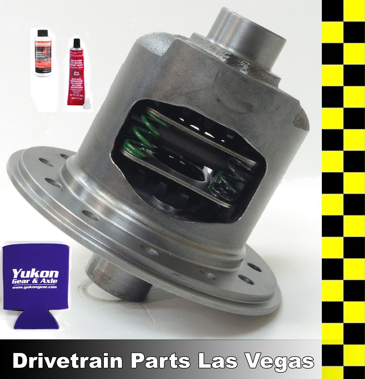

Going to sleep on it tonight but am leaning towards this rear end posi carrier. I have been around these in the past and have worked on a few and they are simple and durable and will work perfect for my needs and the price is right.
http://www.ebay.com/itm/Yukon-DuraLock-Chrysler-9-25-12-Bolt-Posi-Limited-Slip-Differential-Extras-/261493245022?pt=Motors_Car_Truck_Parts_Accessories&fits=Year%3A2010%7CMake%3ADodge%7CModel%3ARam+1500&hash=item3ce236445e&vxp=mtr
http://www.yukongear.com/ProductDetails.aspx?ProdID=9643
