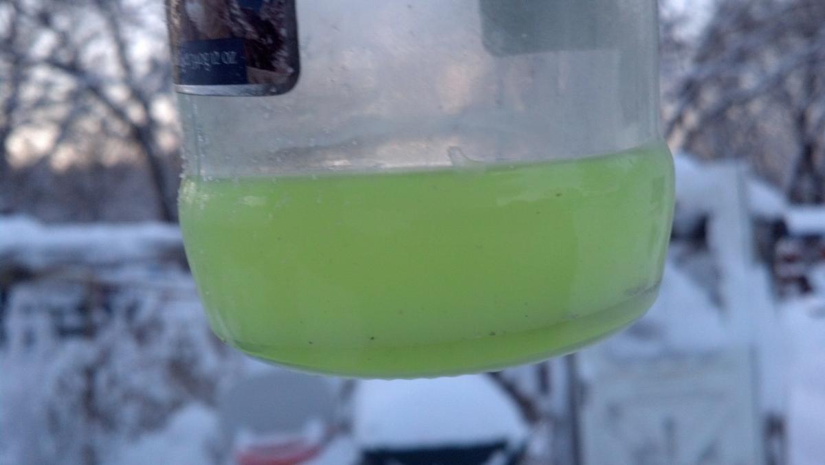

I did not drive my truck today, looked at my sample of fuel it was cloudy about -12 this morning. so they don't lie when they say it's only good for -10.
