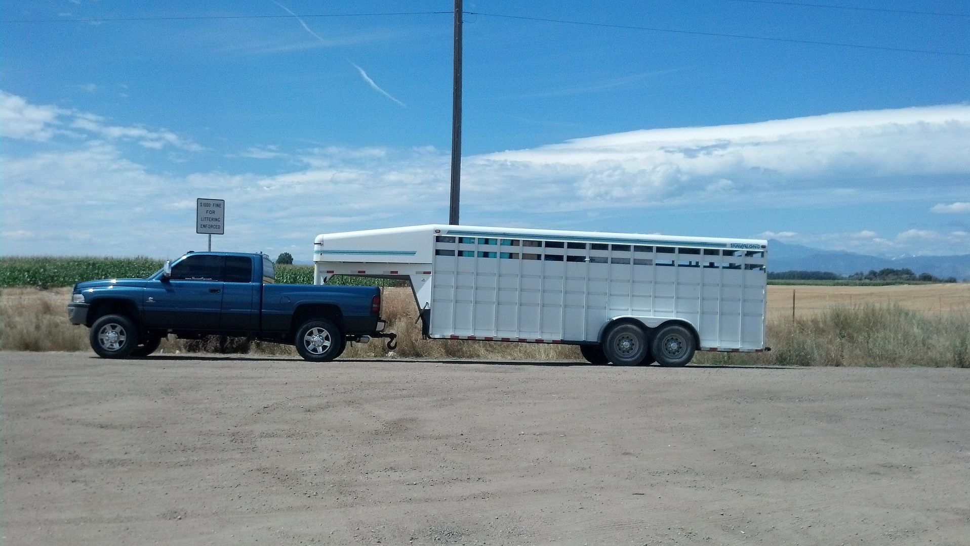

First for the good: My trip was a success. The truck ran really really well! I set the smarty to level 3 with all default settings. I could pull 35-37psi of boost and the egts easily stayed below 1200 driving normally. I ran it hard (pinned) up a steep (very steep!) hill in 5th when the trailer was empty to see what it would do. I started around 55 and let off at 85mph. Egts were just below 1300, boost was still at 35psi, and coolant temp was 202deg. We took the toll road around Denver running 78-80mph the whole way and never had any issues. Coolant temps settled down at 195 with the A/C blasted (Did I mention it was 95-98 deg the whole trip??) The next morning we loaded everything down... the front half of the trailer, including the nose, was packed from the floor to the ceiling with the large furniture and beds. The nose had boxes of lord knows what....The back half had the smaller furniture like dressers lamps ect. It must have weighed a decent amount because it squatted the truck. Scary part was I almost couldn't tell the difference between loaded and unloaded when accelerating. I sure felt it when braking though. We came back keeping the speed down to 70 with the same results as going up. I'm still impressed with how well the truck tows. So much power, egts stay cool, and the turbo spools wicked fast. All in all I'm very happy with the results. And to top it off I filled up at 14.2mpg... not bad for those speeds and a decent amount of weight.

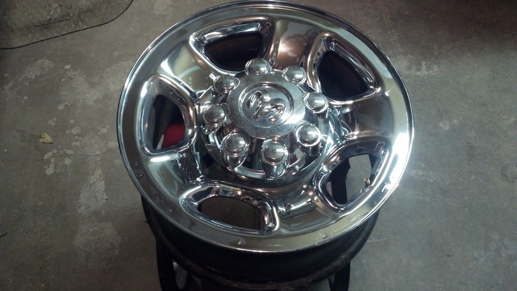

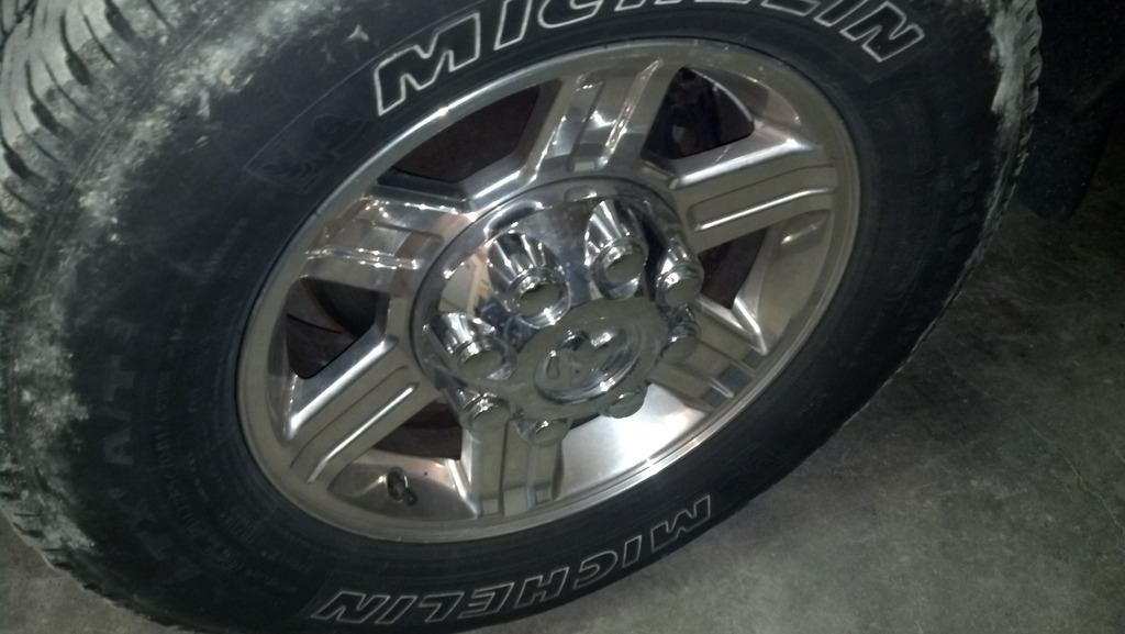

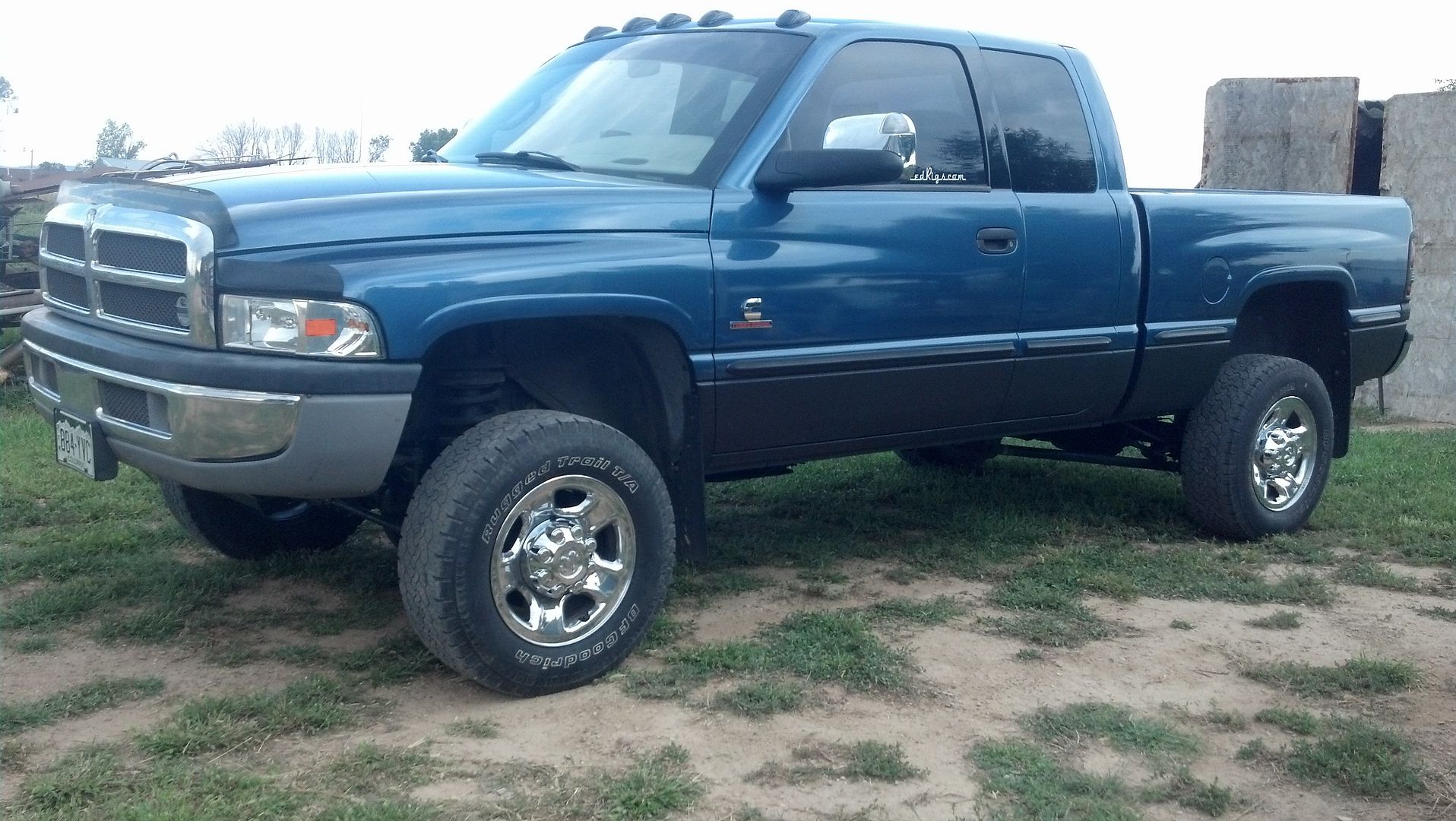

So a little update here. I picked up a set of 3rd gen 17in rims from a buddy. They are the steel ones that are chrome plated. I've got a set of 265/70/17 tires with about 1/4 tred and I'll be driving around 500 miles a week, so I don't want to wear out the nice Michelin tires.  First pic are the current rims, second pic is the new ones. I'll post shots of the truck before and after. I like the ones that are on it more though...

Doesn't look too bad with the new wheels, but I definitely like the "Laramie" wheels better. I finally got my dyno video uploaded too. Can you hear when the TST is flipped on?

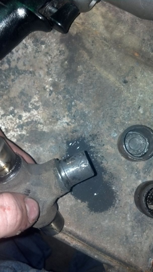

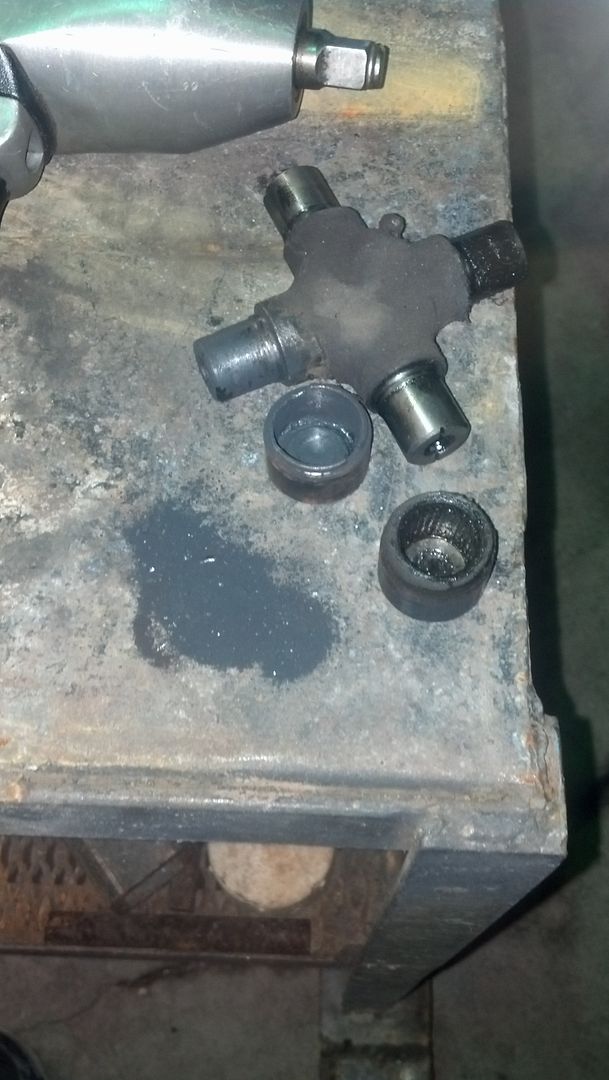

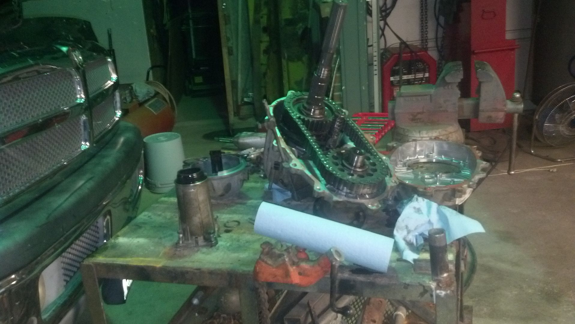

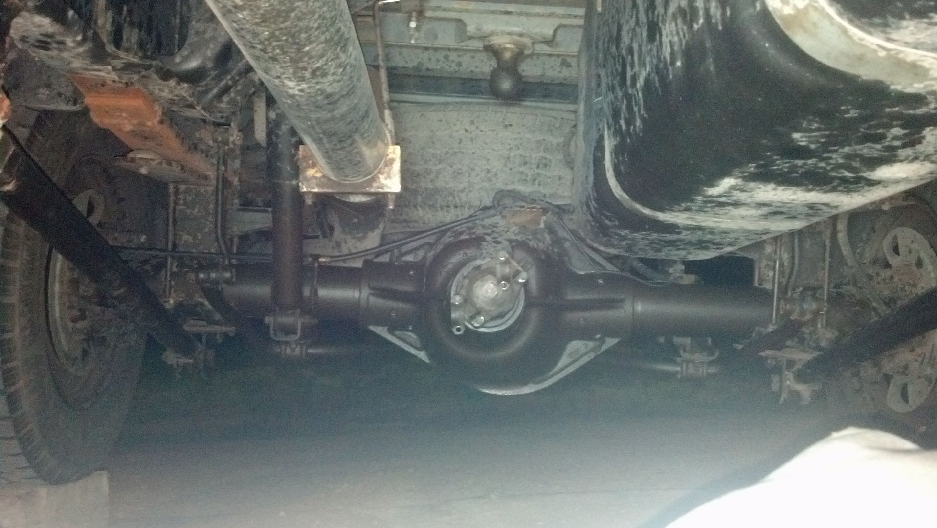

So I had a fantastic day.... I left for work at 4am and noticed a vibration going down the highway. There was also a bit of a chirp at low speeds sometimes. I limped it to my brother's house after work and crawled under it. There was a nice coating of transfer case oil on everything, so I was thinking something in the transfer case was broke. I checked the fluid, put a bit in and finished limping it home. I then could tell my U joint on the rear pinion was bad, just one cap. The vibrations caused the seal around the top of the T case to start leaking  :shrug: Been fine the last 10k miles. O well so I pulled the T case out, resealed everything, drove the U joint out and re-installed the T case. I now see that I need a set of front brakes, and both front U joints are getting bad (One I knew about.) So now I'll be tearing that apart in the morning. Here's some pictures from tonight.
Wierd that it always seems to just one cup that dries out on a joint. I've replaced a lot that look just like that.
