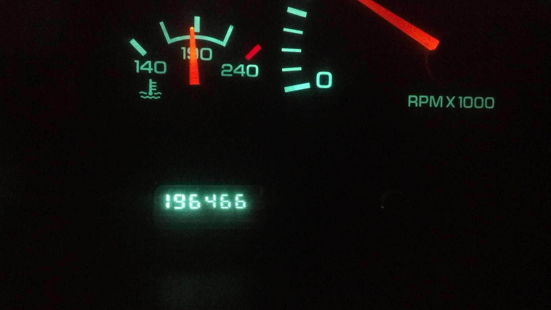

Rolled over to 8K on the motor last night!

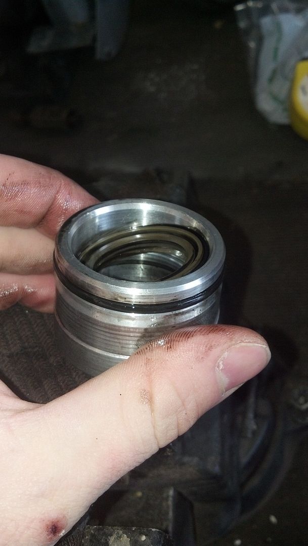

Ever had a seal this crooked actually seal for 6k miles?? The rubber was actually formed crooked from the heat and position.
When I installed the PS pump I must have hit it. This happened when the engine was rebuilt and a new PS pump went in.
Note: I had not touched the seal at this point. Just popped the center section out!
Edited by TFaoro
So what made you pull it out if it wasn't leaking ?
