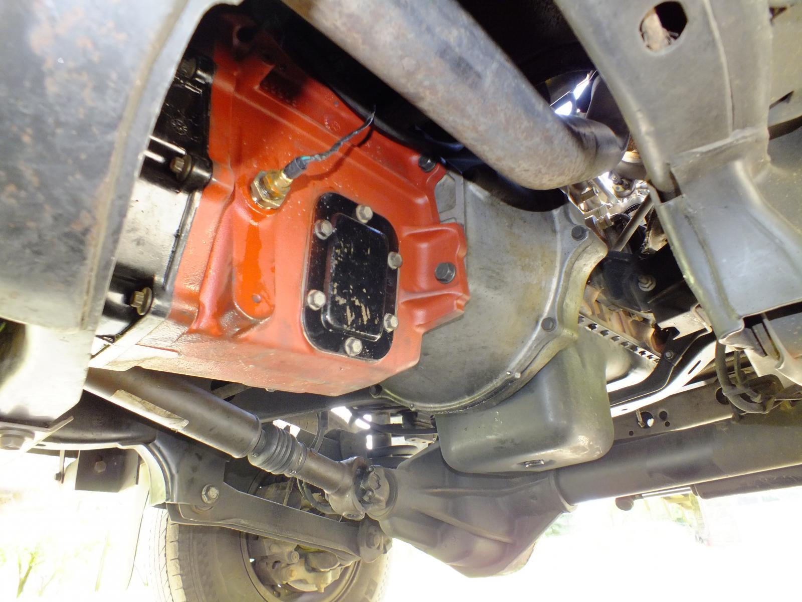

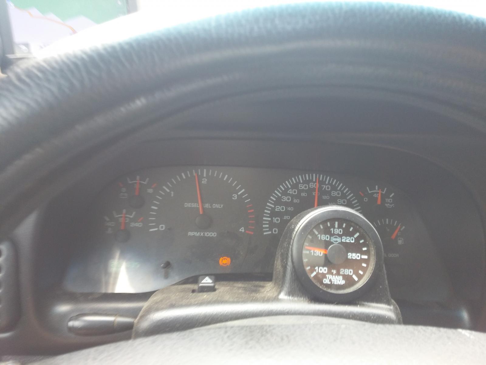

First off let me say... I've followed some of the advise here and double checked a bunch of stuff. The transmission is over filled enough that the sensor is submerged in fluid constantly even in 5th gear and transfer case in neutral. As for the shift quality after nearly 1,000 miles already is still really tight feeling and not sloppy. As for transmission fluid temps empty running I see no more that 130*F tops at 68 MPH after 40 miles of driving even climbing grades. If the morning temperatures are down around 45*F it takes nearly a full 20 miles to rise off of the 100*F mark of the gauge. At midday with 75-80*F temps outside its barely reaching 130*F with flat travel might bump 140*F if climbing a 7% grade.Remember this is all empty truck and no towing... Now you might question the number of the fluid temps from the gauge I've used 2 different thermometers to verify the temperature reported by the gauge and alway darn close to the same value. No I did not install fast coolers nor did I change anything since installing the transmission on the temp gauge other than adding enough fluid to keep the sensor submerged.

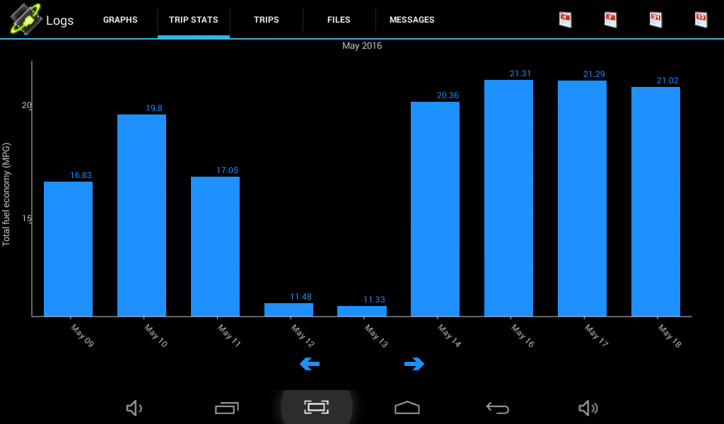

As you see the first few days after the transmission install MPG was bit low. After working hard and pulling thee RV down south and back which would say the break in period of the transmission occurred. Now with the job I had in New Meadows, ID and running back and forth to McCall climbing a 7% grade doesn't seem to bother the MPG's like in the past.

Figure I would update with my fuel logs for the last few days. I've been working a job in New Meadows, ID and leave the house here early in the mornings while the temps are low like this morning it was barely 40*F. The transmission temp never rose off of 100*F. When I got to the job site I did crawl under and hand check the transmission case and it was cool to the touch yet after 22 miles of travel. Even on my trip home it was raining moderate and transmission temp again did not rise off of 100*F.
