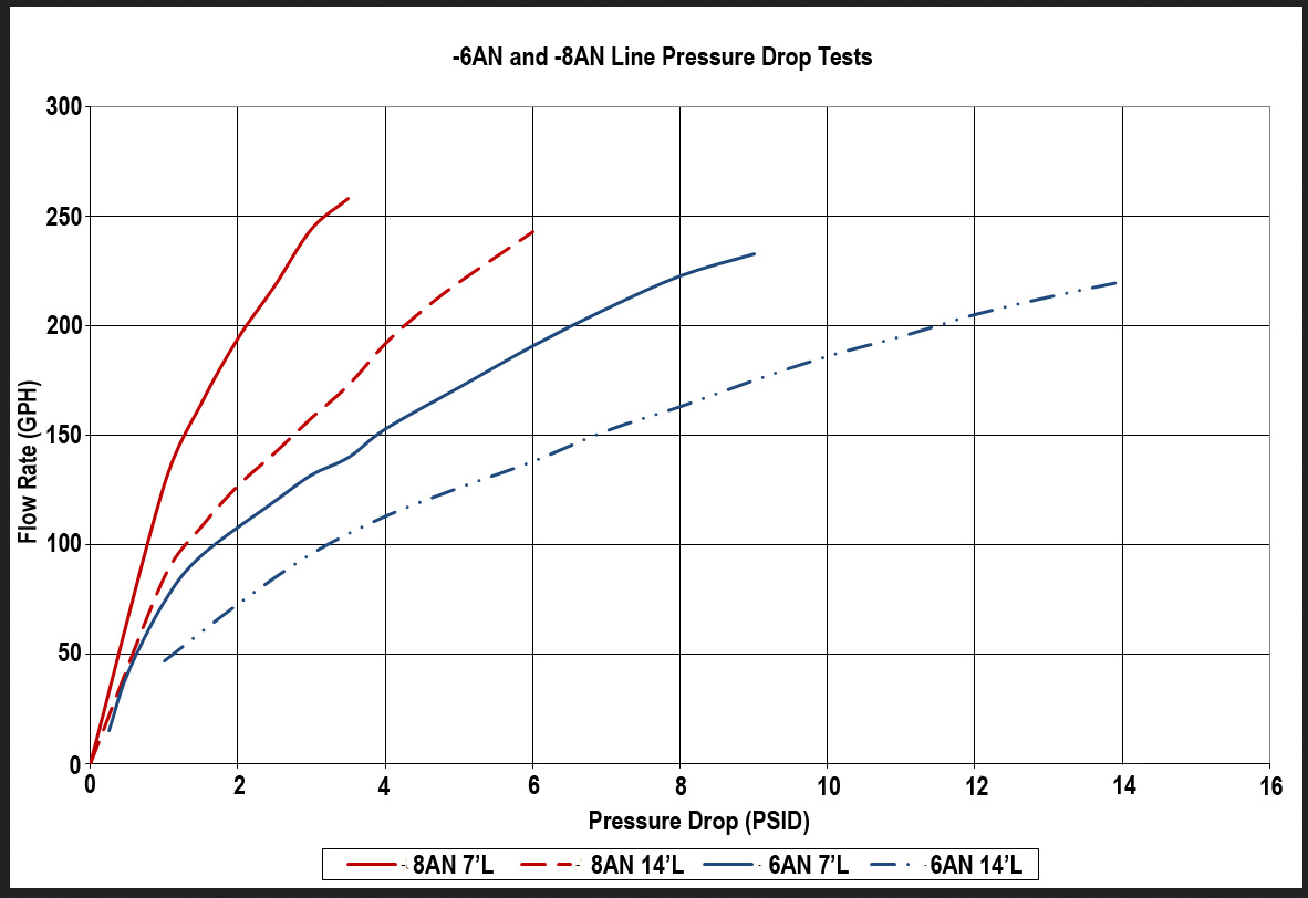

Any kind of direct replacement pump is not going to work. The problem is all the banjo bolts and stock 6mm (0.23622 in) fuel line needs to go away. All fuel system kits change over to full 1/2" from the fuel tank to the injection pump.

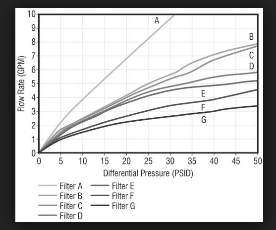

Then with the Airdog or FASS and a Big Lin Kit from Vulcan you can keep the stock filter which now allows for double filtering of the fuel. This extends my filter life so far to 60k miles per filter change.

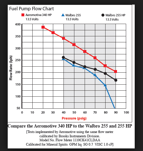

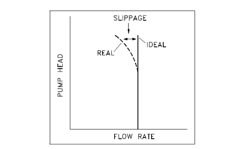

High volume pumps have better pressure stability. So 95 GPH pump will have larger pressure swings. Like I'm around 400 HP realm and only have a 2 PSI swing from idle to WOT to 100 MPH. If you opt for a 95 GPH pump you might see 5 to 7 PSI swings.
Simply. If your supply volume is greater than your demand volume the pressures do not fall much. Then if the demand volume out weighs the supply volume the the pressure falls.
So if your looking for VP44 longevity then you need to keep above 14 PSI all the time. My AirDog 150 hold 17 at idle and 15 PSI at WOT.
95 GPH is good for true stock and no towing. No tuner. Stock injectors. Just stock daily driver.
