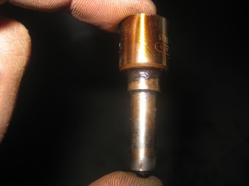

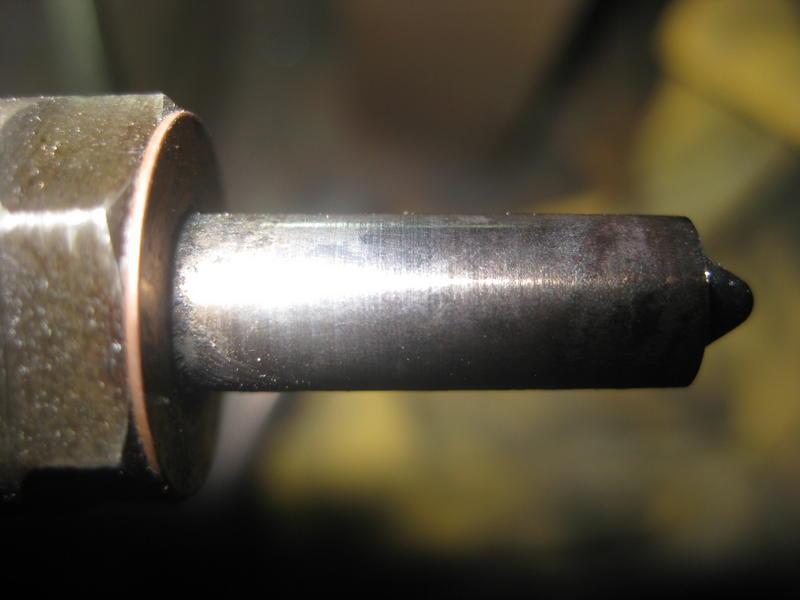

Well gang... I finally had enough of the random misfire that I was having. So this morning I broke down and got the shop clean up enough to get my truck in. :rolleyes: So I did the typical disassembly and got the injectors out...post-2-138698166538_thumb.jpg This is the internals of a 24V injector (RV275) What I did was made a jig to hold the injector while you remove the nozzle nut. I used a allen wrench in a vise to make said jig. post-2-138698166553_thumb.jpgpost-2-138698166545_thumb.jpg Then before you can remove the nut you need to remove your copper washer. This can be done with a putty knife and a hammer just lightly tap the putty knife and it should be able to pry it up enough to using a screwdriver. post-2-13869816684_thumb.jpgpost-2-138698166832_thumb.jpg Now as I set my torque wrench for loosening and kept adding torque to the handle adjustment looking for the click and loosening of the nut. Well I found it at about 32 foot/pounds so I backed off to 30 foot/pounds and set the wrench. Loosen the nut. post-2-138698166859_thumb.jpgpost-2-138698166849_thumb.jpg Now you need a clean area too. I set up a shop towel and a old ashtray. I filled the ashtray with Coleman fuel (Naphtha). So I would open up the injector carefully and place all the parts in the solvent to soak. Now in the pic above there is a shim that goes in the bottom below the spring. This shim might be stuck inside the body don't sweat it let in soak in the Coleman fuel for about 5 minutes and pick it up and it will fall out. Now that all the parts are soaking take a old scotch bright one thats been used a bit and rather soft. dip it in the solvent and light rub the nozzle clean of soot. Yes you may rub the tip but be gentle about it. Now look at the pintle (needle) look at the tip for damage or wear... Now check it for smooth sliding action in the nozzle. If it feels rough rub the pintle gently with the scotch bright pad and it will help it out... post-2-138698166873_thumb.jpgpost-2-13869816688_thumb.jpg I was doing a mini-spray test too... Dip the nozzle in the solvent keeping the fuel hole up and holding the nozzle horizontal using a blow gun just a light burst of air will show you your spray pattern some what but also insures the nozzle tip is not plugged. Now just blow all the large parts clean and dry from the solvent. Make sure to blow the fuel passages clear. Once you happy with the clean up and every is clean now reassembly the injector exactly the way it came apart. Put your shim in the body take notice of which side was up. You'll also notice the shim has wear marks from the spring so be sure to put it back in the right way. This side down. post-2-138698166888_thumb.jpg Heck... Let me get more pics and I'll continue this write up...:thumbup2:

Continued... Well the shim has to be this side up... Take notice to the side that has the wear mark for the spring...post-2-138698166896_thumb.jpg Then place your spring the the body. post-2-138698166913_thumb.jpg Then there is a cone shaped piece that goes on top of the spring but make sure to place the hollow side up. This is for the pintle to ride in. post-2-13869816692_thumb.jpg The mid body goes on top of this take notice to the pins it will only go on one way... post-2-138698166905_thumb.jpg Then your nozzle and pintle goes on top to look like this... post-2-13869816696_thumb.jpgpost-2-138698166939_thumb.jpg The pics I did of one of my stock injectors... Yeah I did it in a hurry and they are not very clean but I'll do them next tomorrow. I'm really shocked at how it change the injector noise, performance is better, smoke is less, clatter is less, etc. But after doing this I now know without a doubt that there is no injector cleaner on the market that can clean a injector. Just soaking them in naphtha (Coleman fuel) would loosen the soot but you still have to go after it with a scotch bright pad to get the carbon off the injector. The pintle have a yellowish tinit but soaking them does nothing either... You still got to attack the pintle with a scotch bright pad too. The soul fact that you need to soak the body to get the shim out is un-real. You can tap it on the desktop and it refuses to fall out... But soak for 10-15 minutes and it falls out in your hand. So after now doing this I going to say after about 100K miles it wouldn't be a bad idea to take them apart and clean them out really good. When I do the stock set I'll take my video camera down to the shop and setup the tripod and shoot video of the assembly and the spray pattern... I know at low pressure it doesn't appear right but you know the holes are open. :thumbup2: Another tidbit... RV275 is 820 nozzle number... and strock 235 HP is a 830 nozzle number...

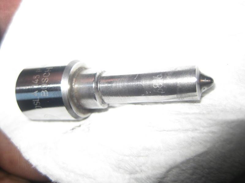

So I popped out another one because I found something else to clean it that wouldn't scar it as bad. Here is the scotch bright way (from first injector) and then todays injector using cameo aluminum and stainless steel cleaner. What's interesting is I spent 10 min to get that much accomplished with the cameo, that's the only thing I hated about the scotch brite, it was like taking a grinder to them. I wanted something that would do it easily so I could stop before going too far. The cameo actually got the majority off within a minute but the tip needed a lot of TLC to get it all cleaned up. Scotch Brite http://www.mopar1973man.com//isx97/Truck%20Stuff/Ryan's%20Dodge/Under%20Hood/Injectors/Cleaning%20Internals/A.JPG Cameo http://www.mopar1973man.com//isx97/Truck%20Stuff/Ryan's%20Dodge/Under%20Hood/Injectors/Cleaning%20Internals/B.JPG Scotch Brite http://www.mopar1973man.com//isx97/Truck%20Stuff/Ryan's%20Dodge/Under%20Hood/Injectors/Cleaning%20Internals/A2.JPG Cameo http://www.mopar1973man.com//isx97/Truck%20Stuff/Ryan's%20Dodge/Under%20Hood/Injectors/Cleaning%20Internals/B2.JPG
Hence... Why I got a USED scotch bright pad one that was really soft and won't scar the injector... I know what you mean about a new pad it will eat the metal right up and scar it quick... As for the Cameo could you post a link to the product I've never heard of it...:shrug:
