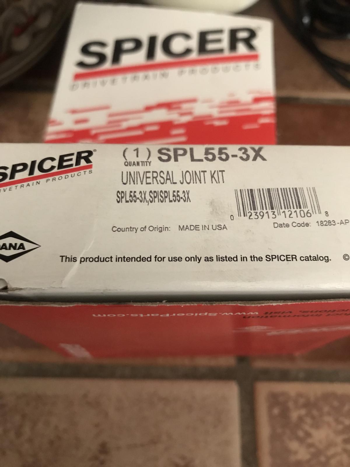

I ended up purchasing spicer SPL55-3X from rockauto. Thanks guys for your help with this.
The u joints showed up today. Beefy units, I looked and they appear to be the identical units as the stock u joints.
MADE IN THE USA-maybe everybody else knew this.
