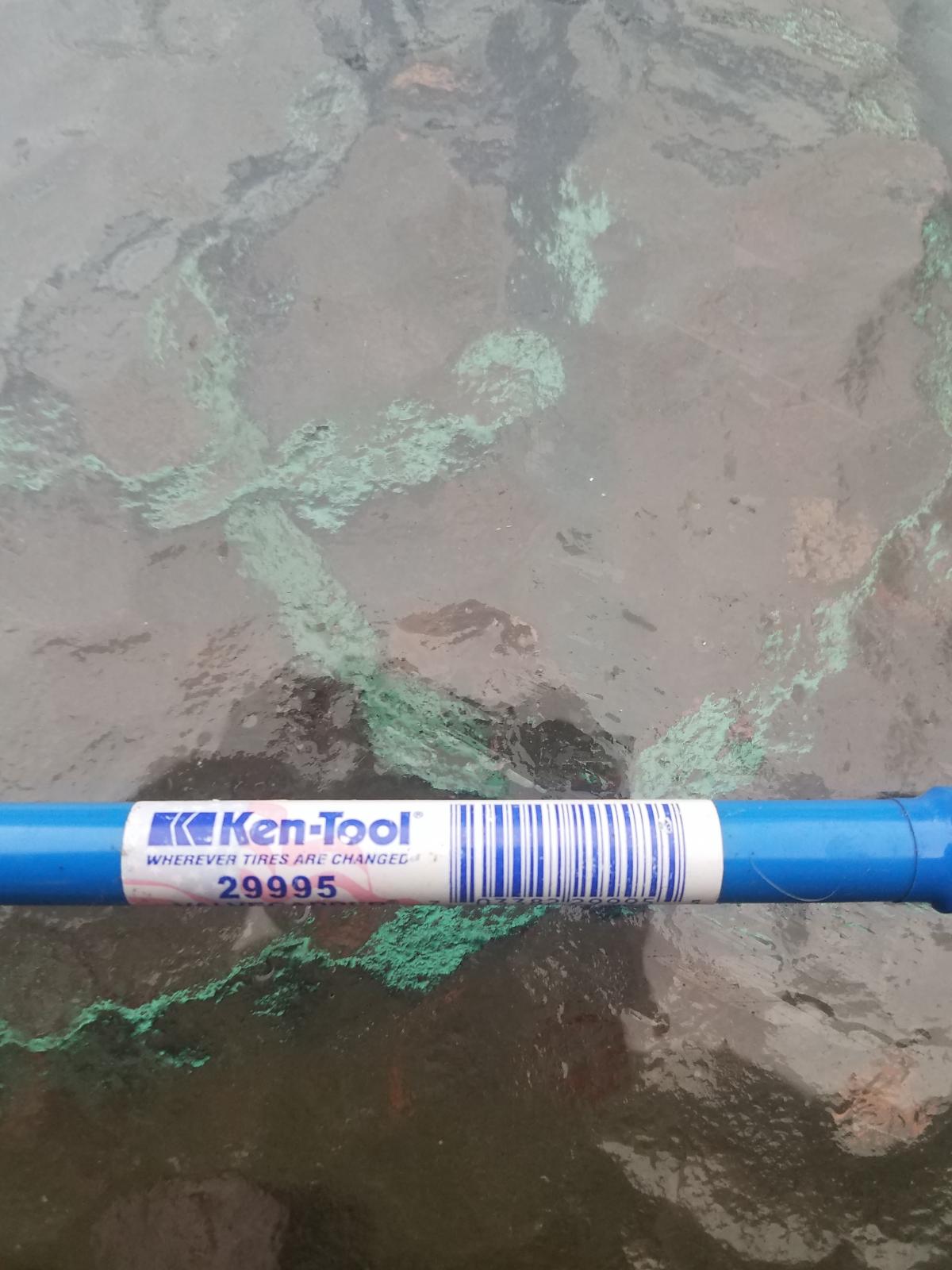

  • I've done away with valve stem extensions maybe 10 years now.   But I do have a gator caps on.  I picked up a long reach valve core extension remover to remove/tighten etc valve cores.  And I check or

  • I'll post a picture of that tool I have at my next time I run across it.
I've done away with valve stem extensions maybe 10 years now.   But I do have a gator caps on.  I picked up a long reach valve core extension remover to remove/tighten etc valve cores.  And I check or add air with an offset fuel head air chuck.  Very little chance of failure running no extensions.  Hardest part now is holding flashlight to get ahold of the cap.

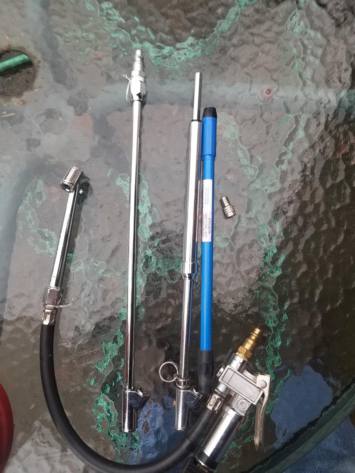

I'd also like to see a picture of an offset gauge and chuck that allows access without extensions. I've been running with extensions for 11 years now without ever an issue but I've never really felt comfortable with them.

Here's a pic of all my extended reach stuff.  No extensions to leak. No hassles with branded lines.
Hmmm. I have that stuff. But without an extension on the stem it's too close to the tire to get on it straight. Both my gauge and chuck are that way. Unless the angle on mine is too shallow?
Edited by dave110
That one chuck with a rubber hose that's why I bought it, the long metal one not enough flexibility to reach in to get good seal to air up.  maybe putting a bit of pressure on it been to bend it a tad.  Careful with steel,  brass a little easier to bend a tad.
I bend the long air chuck. Stick it in a trailer rail or something until the bend is adjusted correctly to air up inside dual.
Seems a small straight air gauge works most the time.
