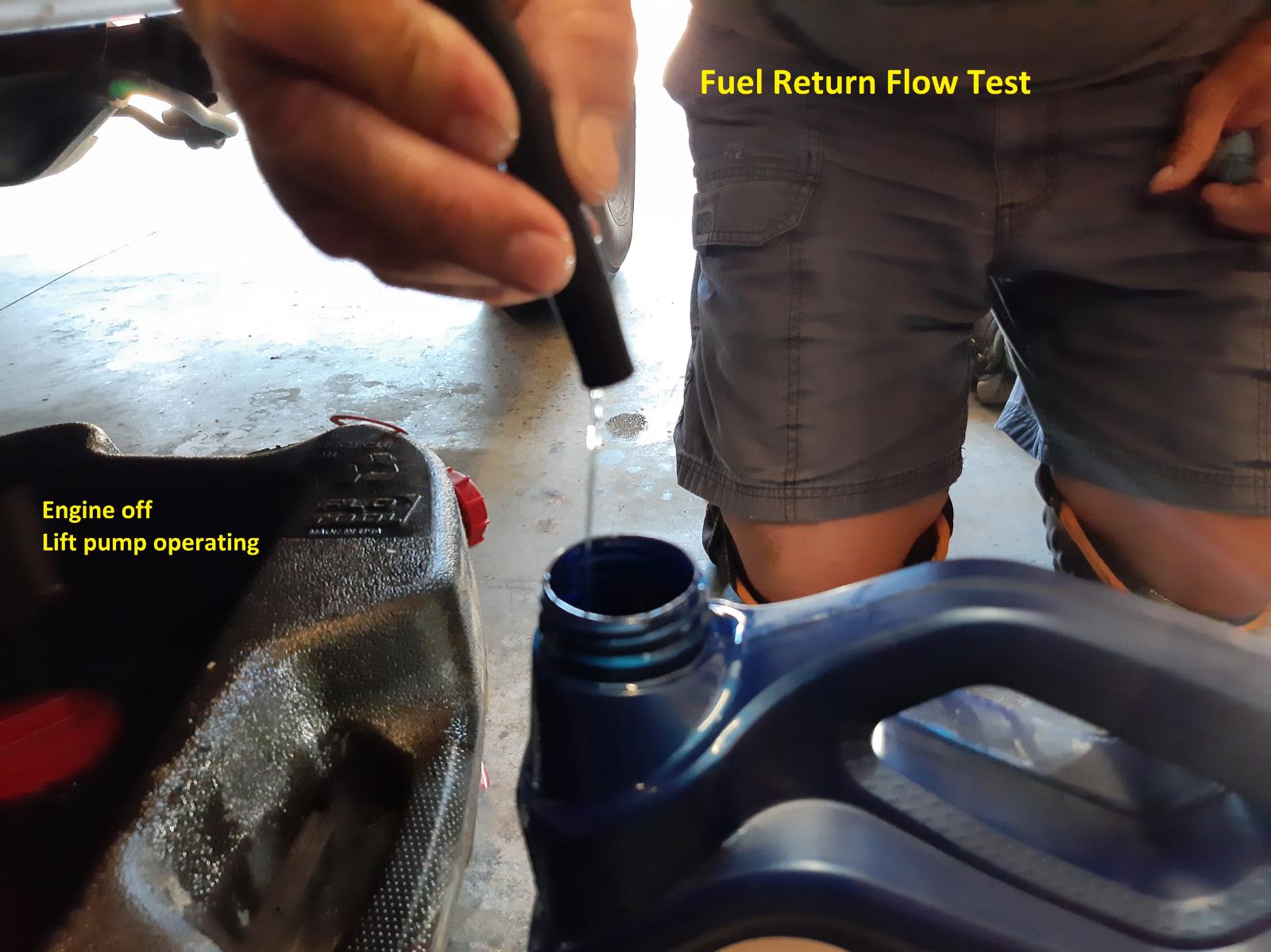

Good, you got it to "show fuel pressure" NOW stop this "twenty second" run stuff right NOW!
Get yourself a couple of test leads with little alligator clips about 12 inches long or perhaps longer (no worries)
Un-plug the trigger line from the ECU that "is supposed to be" triggering the isolation relay.
Take your test leads and connect them to the relay coil pigtail that was previously connected to the ECU trigger line.
Now, take your test leads and source 12 volts directly to activate the isolation relay.
This will force your Raptor into "a continuous run" condition, because you have manually provided 12 volts to trigger the relay.
You should hear the Raptor run immediately when you trigger the isolation relay. LET IT RUN !
NOW, go open your fuel filler door, remove the fuel cap and put your ear to the hole at the filler-neck and listen. Once you hear fuel being returned to the tank you should see fuel pressure. If NOT, your "peanut-whistle" feed-line has a frozen booger clogging the pathway.
4 hours ago, Doubletrouble said:
 Also had the battery charger on it all night at 6amps, maybe that'll help. I don't know. In all my years of truck driving this is the first time I've had anything freeze up in the fuel line like this.
Good, leave the 6 Amp charger hooked up while you do this and let the Raptor RUN !
NOTE: quiet conditions are required when you are trying to hear liquid flow being returned to the tank.
I know it's cold and miserable at your location...stay with me...
In this "force run condition" this effort may require getting under the vehicle with an industrial heat gun and began "heat tracing" your peanut-whistle fuel lines.
BOTH feed and return must be HEATED to restore the full circulatory aspect of your system.
It will cause NO harm to continuously force run your Raptor in this TEST scenario and the battery charger will prevent pulling the head-charge off your storage cells.
The force run condition without the CTD rumbling in your ears should allow you to "listen" for success once the system is fully purged and free-flowing.
Most likely, you'll see a fuel pressure indication once flow is achieved.
I strongly believe following these suggestions carefully and remaining focused on the details will yield successful results.
Removing your temporary test leads and restoring your ECU trigger line to the isolation relay, returns your system to standard operational condition.
Please, do NOT "test lead" 12 volts into the ECU trigger line...that, is a direct act of buffoonery!
