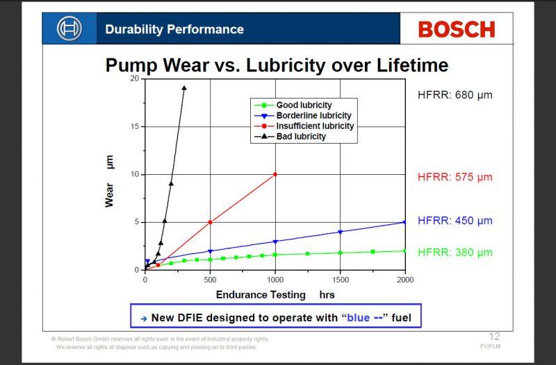

I think there is a misconception about kerosene. It is not as dry as sand. The machine shop I worked in used kerosene when machining things and it worked great. True it doesn't have the lube of regular #2, but it still has lube in it.
I have no idea how worthy 911 is. Regular power service anti gel is uh, an antigel..so what is 911? Only thing I can think of is it must be extreme and have extreme anti-lube properties.
According to this page, regular PS is crap, only improving HFRR a little. Which means the antigel PS must really suck, so now where does that put 911..
Even here on post #41, he says "I have seen a LS#2 mixed with ULS#1 and the HFRR result improved (on multiple tests)." Which is LS#2-Low Sulphur #2, and ULS#1-Ultra Low Sulphur #1 (kerosene).
Here it says in post #14 "Jet A is just kerosene and I get drums for free. Jet A has a HFRR wear scar of 670. ULSD untreated has a HFRR wear scar of 640." Further showing it isn't dry sand, it is just 30 points behind the regular #2.
I would use mixes of kerosene (#1 diesel) first.
