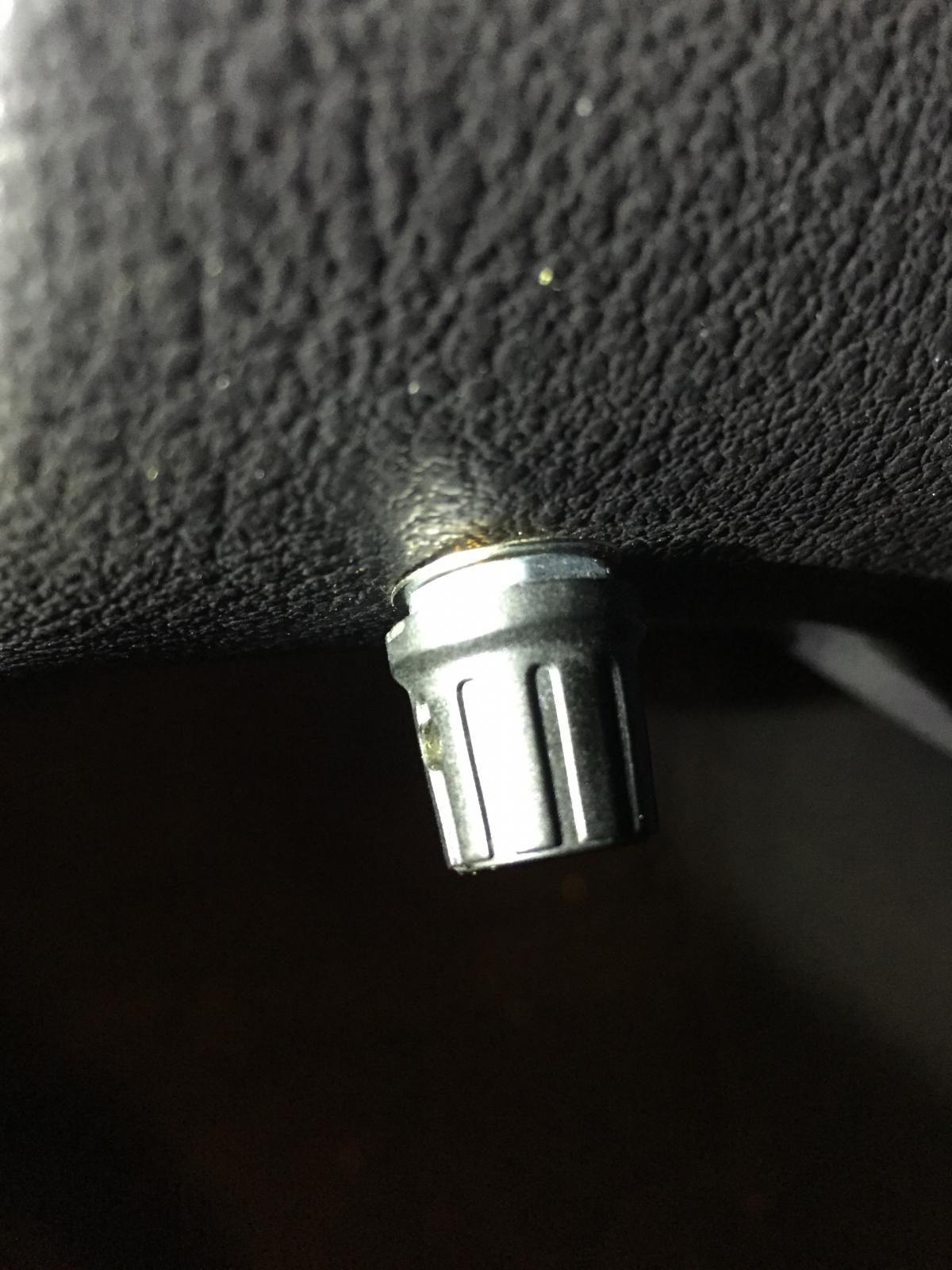

So I'm having my dad cut me out a piece of aluminum to use as a backing for the high idle switch so I can either put the sticker on that or get it etched or lasered to match the sticker. My question is when I was installing I initially drilled a 1/4in hole like the instructions said but it wasn't a big enough hole to fit the threads through. Did I install it wrong?
This is how it looks
No you are right in thinking that 1/4 is too small.  I forgot to update the install direction.  Needs to be a 3/8 hole.
Pull the switch out and redrill the hole 3/8 big so the threads come through the hole fully.  Then use the locknut to secure it.
