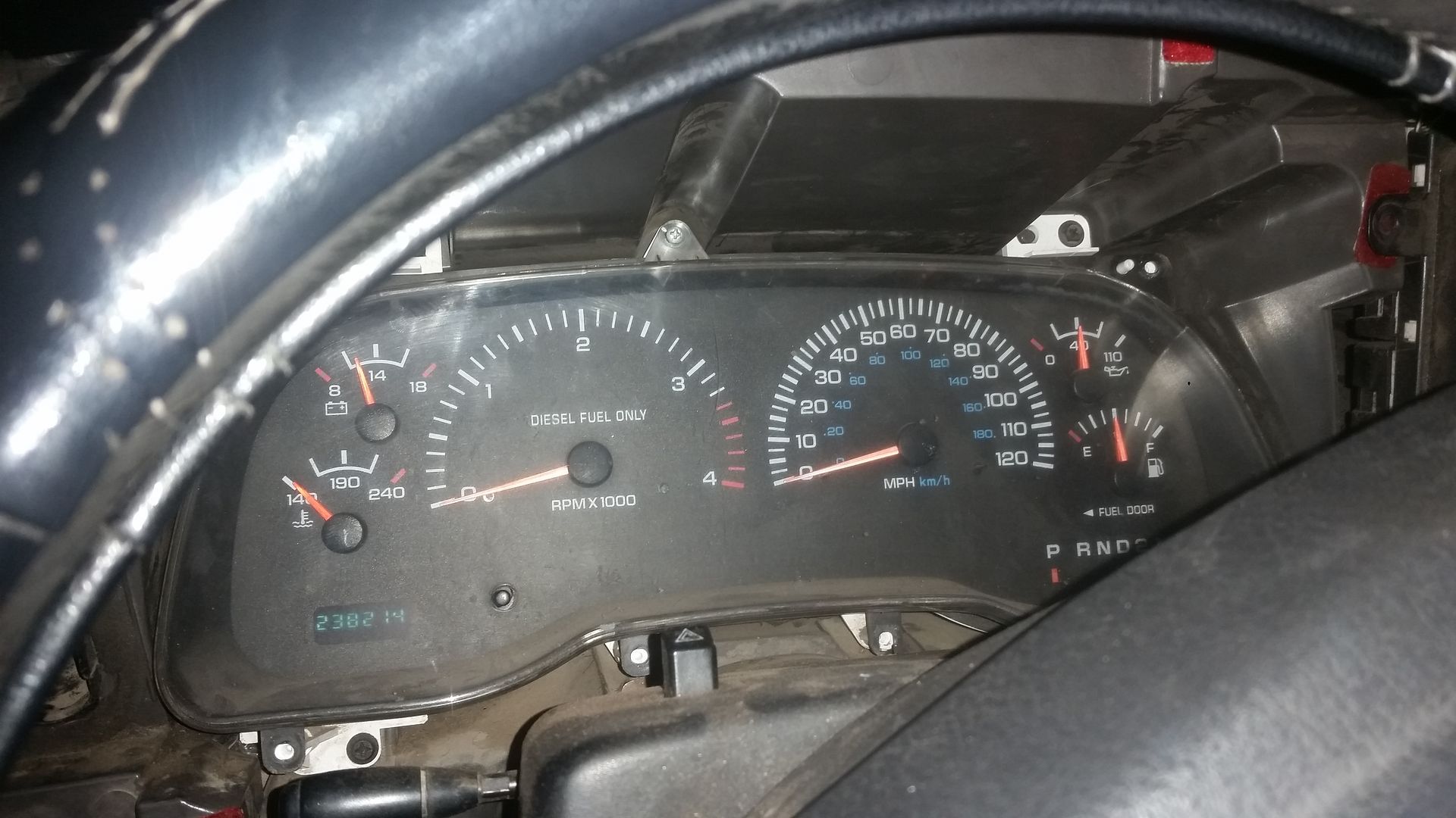

New cam. My guess is the journals were damaged before. @CSM  i just rlied on h cluscluster for my op reading. @Mopar1973Man
The gauge reading for oil pressure is a dummy gauge.  You can tell by just turning the key to on position ( not starting the engine) and you will notice the oilpressure gauge go to right in the middle of the range.  Since the oil pump is driven off the engine it is impossible ot have pressure without the engine running.
While I understand the dummy part of the gauge, I have never seen mine move until after start up. Just went outside and turned the key on and watched it just lay there for 60 seconds.
mine goes right to middle mark engine off, strange.
I dont remember mine ever doing that, but i seem to remember something that Mike did when the high idle switch was a gleam in his eye that made the gauge do that. Not sure that was it but it was something he was messing with a good while back.
i will check mine tomorrow.
gotta love that magic oil pump :shifty:
