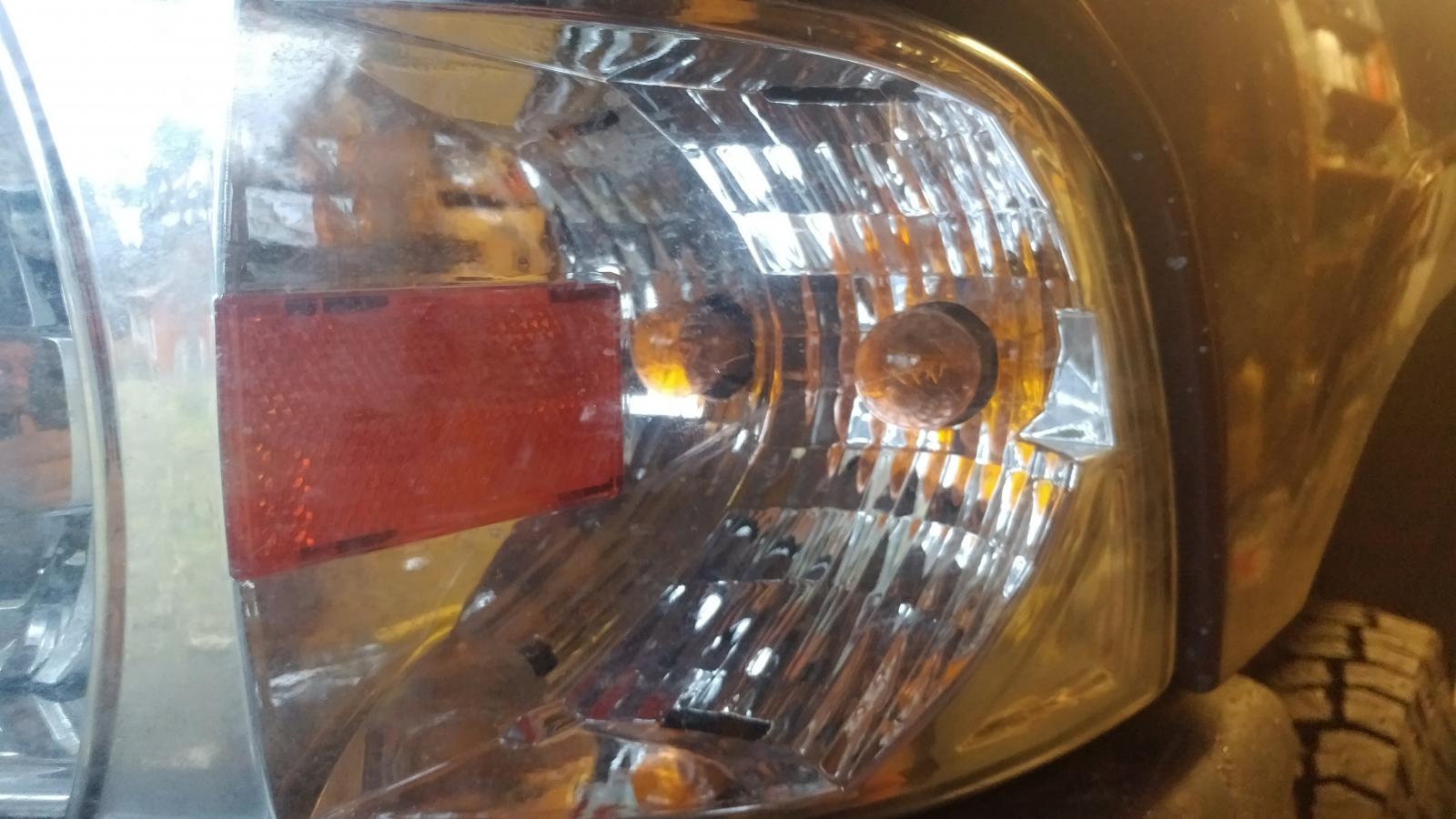

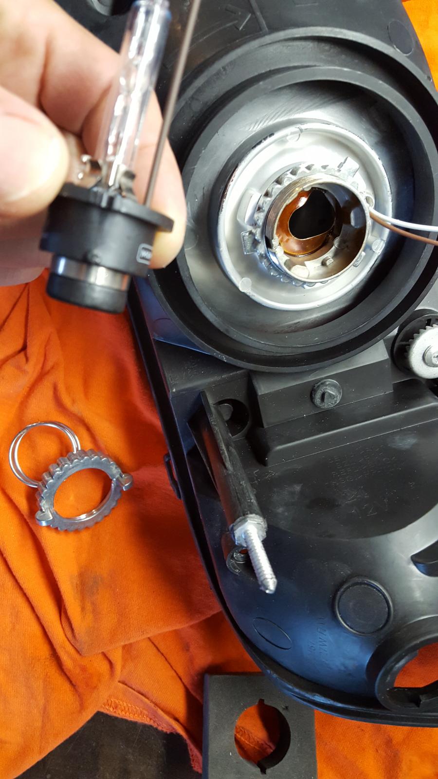

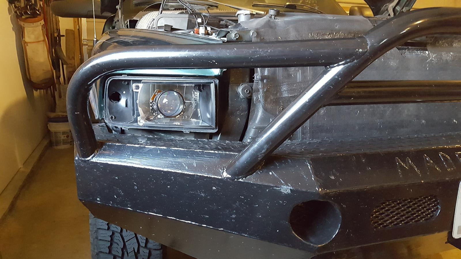

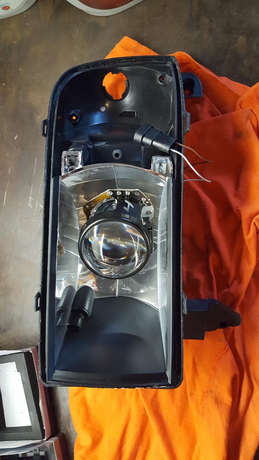

20171130_175124.jpg.f1b9ad1c39619dee837e796d7ff22d50.jpg20171130_193302.jpg.a24f32d40c7755f11b8bd05941abef2e.jpg20171202_082403.jpg.bd029e95f7692e15b7ee7439913effe8.jpg20171202_082513.jpg.787dc77be66354a607af19c34b946c05.jpg20171202_082541.jpg.7c79e21e5aa98b78d4c367fcdb6c96ba.jpg
Picture before last, there is a little white dot about 1/4" by turn signal bulb, that is a vent I was talking about @Mopar1973Man

Yeah it's behind turn signal but still a vent to housing, I'm not too worried about it anymore. Still scratching my head on where to mount all the hardware, don't want to do it twice but seems like anything I do is at least that.

OK found a good place for ballast, just on the other side of battery, Used SS self tapers that I was able to put in through signal light hole.
Also hi/low beam was backwards like in a lot of cases, so it Brown and White that need to be switched around in morimoto harness.

Mike are your lights cross-eyed at distance, what I mean is up close lights seem parallel but after about 50 feet they meet and then go opposite way. I'm not sure if at certain point they need to meet or not. Oh yeah I'm kicking myself self in the as. for not just buying a done set lol, Mini's H1 would definitely be easier to do, but I'm determined now :shifty:. Drove around a bit man what a difference, high beam you need benaculars to see that far. Now just need to finish adjusting beam and fit shrouds, we'll and put lenses back on housings.
First picture is where you can see how left beam is over right and right one is slightly higher.
Second picture you can see driver side cutoff line is too far on the left
