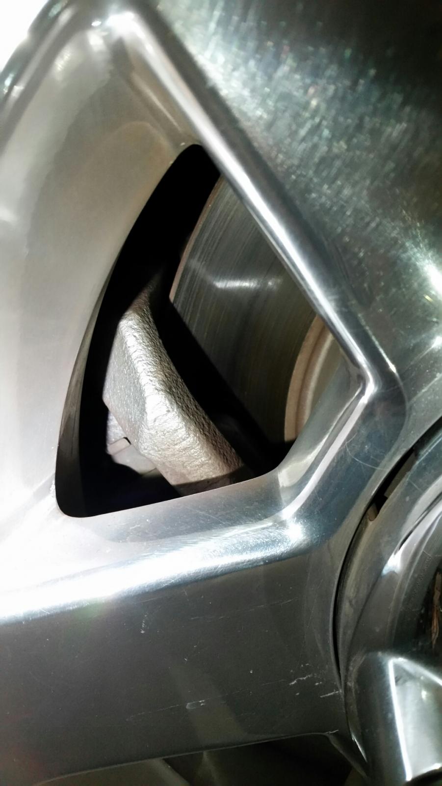

And I "borrowed" that picture from Google! Hope the brakes work as well for you as they have for me!
Food for thought, you may see an increase in brake dust with those. I went with Carquest severe duty semi-metallic pads, and the brake dust is absolutely horrible. Also, they squeak really badly peri
I have the same stuff for my wheels, and I wash the truck once a week, so I can kinda keep it under control. It gets really bad after I tow. Then the front wheels go from polished to gun-metal grey
It was finally time for front rotors and pads so I went ahead and did the 3rd gen caliper brackets, rotors and pads. I've ordered the brake line kit @jlbayes suggested a Russell 694540 as well. All I can say is it's well worth doing! Thanks @trreed for the positive report back after doing the conversion and towing with them...and I "borrowed " your pad comparison picture from your thread.
