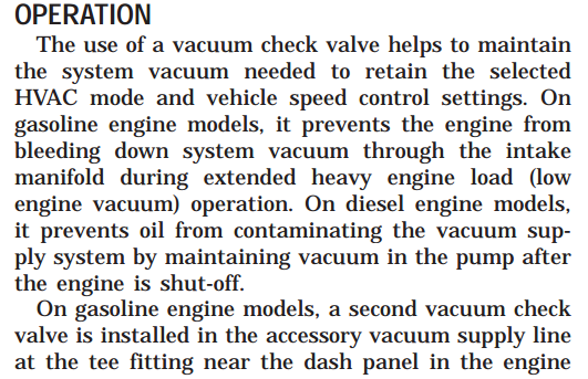

Quote from 2001 FSM Page 24-29
the check valve is not shown in the picture I attached at the end, but basically, the check valve goes in the "vacuum supply" line.  This means that when you turn off the vehicle, and the vacuum pump quits rotating, all of the components further down the system stay in the proper vacuum positions.  In gas engines it is very important, as when you open the throttle, manifold vacuum goes down.  So during acceleration, all the actuators would change position.
IF there was no check valve, in our trucks when the engine was stopped, the vane type vacuum pump will allow all the vacuum to escape backwards through the system, so all of your actuators would relax and move while the truck is off.
It is by no means a killer problem if the check valve is broken (as long as it allows the vacuum to operate properly when the truck is running.)  Just don't put it in backwards.... you won't have any function of what you need.

Notice in the FSM description for diesels..... The check valve prevents oil from being pulled up the vacuum line at shut off. (since our vacuum source is relatively constant, not manifold pressure dependent.)  So it really doesn't matter where the check valve is.

Mike read 24-28 and 24-29 of the 2001 FSM.   On Gas models there is a second check valve that separate the HVAC from the cruise Servo.
Our system in the FSM shows only the "main" one at the pump.  But I agree with you, we have both seen a second check in the dodge system, and that was probably on the cruise servo.  We also don't get the vacuum reservoir gassers do.  I think the engineers figured that the mechanical vacuum pump was strong enough at all engine speeds to always supply enough vacuum.   But since we have seen those check valves, maybe there was a running change help solve some issue, but never made it to the FSM
