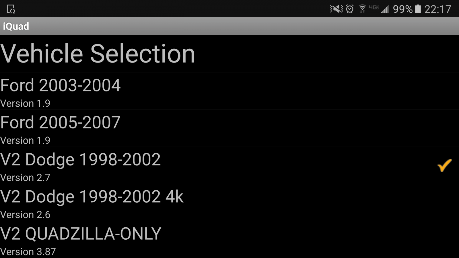

That's something that never made it out of beta stage. Your tunes cannot utilize it. You must be using the V2 Quadzilla Only profile. Choose the V2 Dodge 98-00 profile.
Interesting... where’d you download it from and what version is it?
This is what I'm using About 4 mouths ago I was using bottom one. Now everything should work with 98-02
Recently my cheap ebay tablet died so I actually bought a nicer tablet. Upon installing the iquad app I noticed that their was an update or something and now their is a wire tap % category in the tuning section. How do I do about utilizing this?
