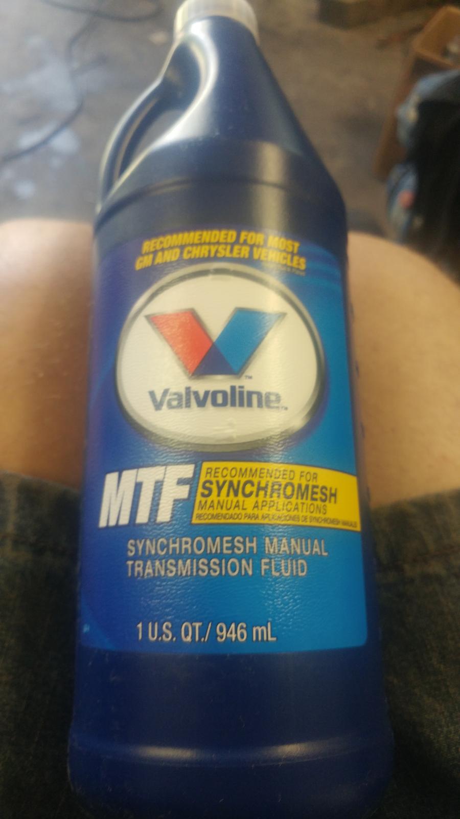

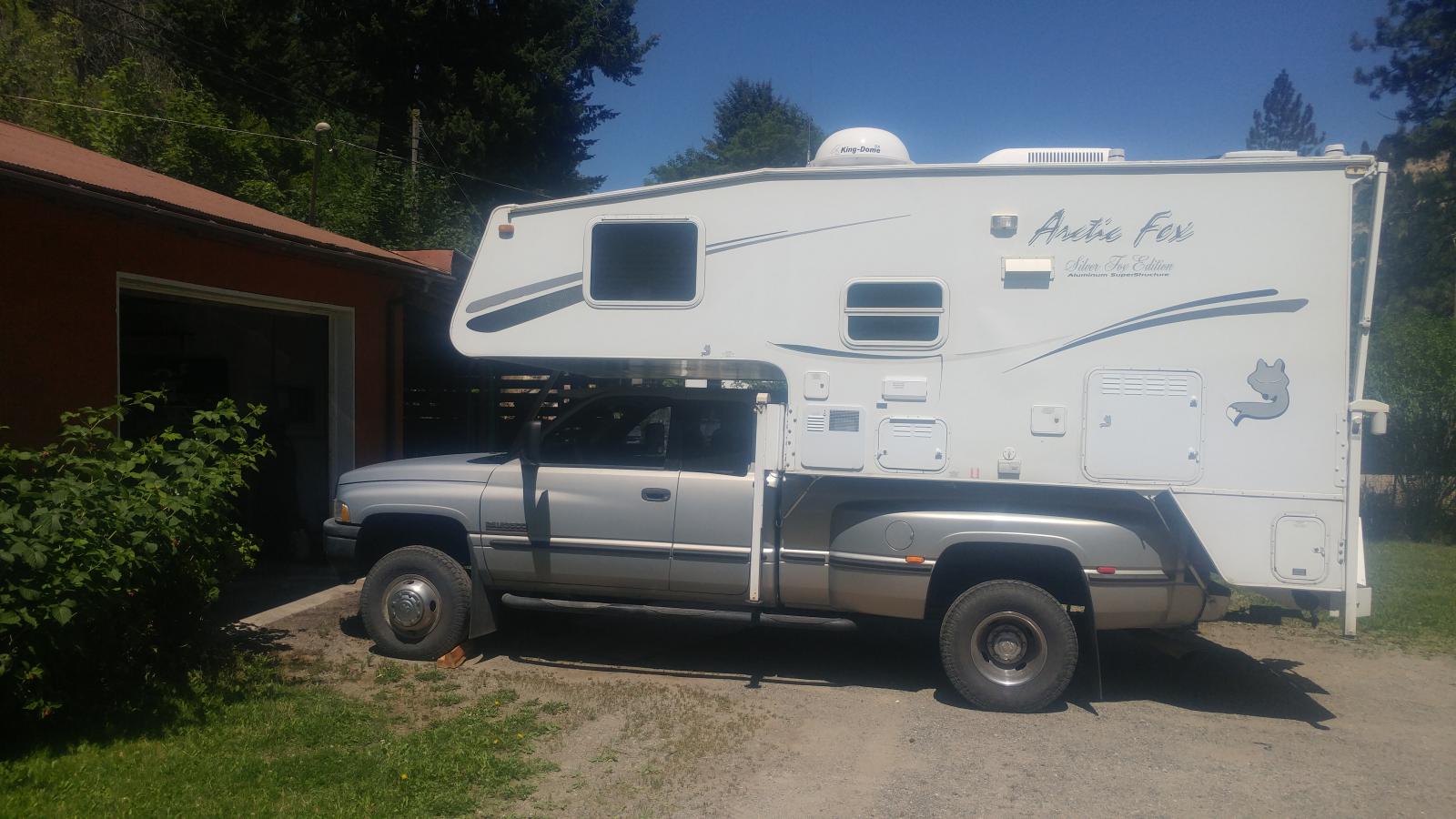

Had to share on of the locals wanted the diff and transmission fluid changed. I did find another transmission fluid for NV4500. It is a GL-4 75w-90 lube. Limited slip rear end with 75w-140.
