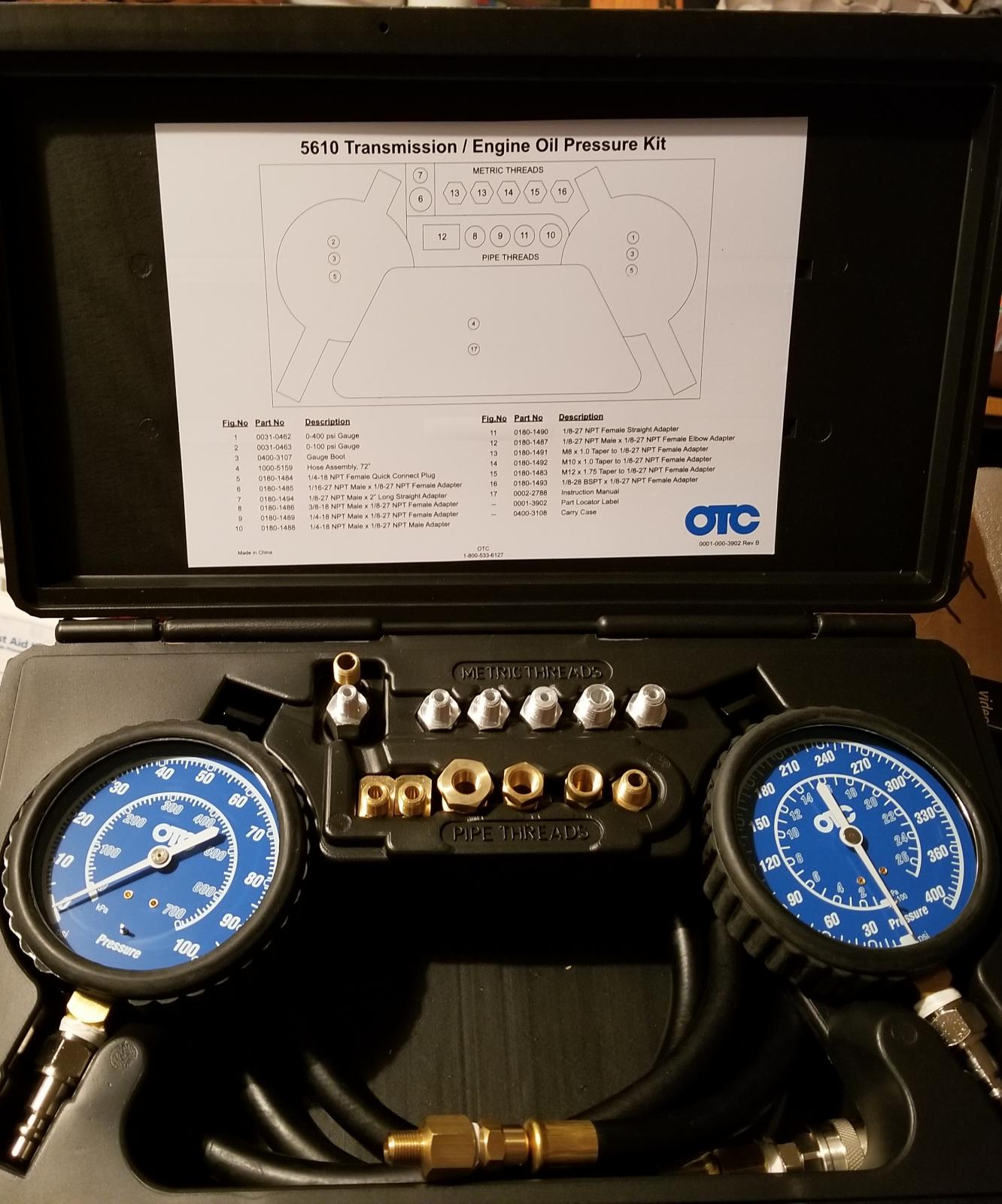

Have not used this yet but I picked this up from Amazon for $57 it seems like a really nice set. Has 400psi and 100psi.

That 0-400psi gauge has a pretty decent hose set up with a quick release like on a air hose. Will have to check the hose rating now.

Those OTC gauges are good quality, FWIW.
