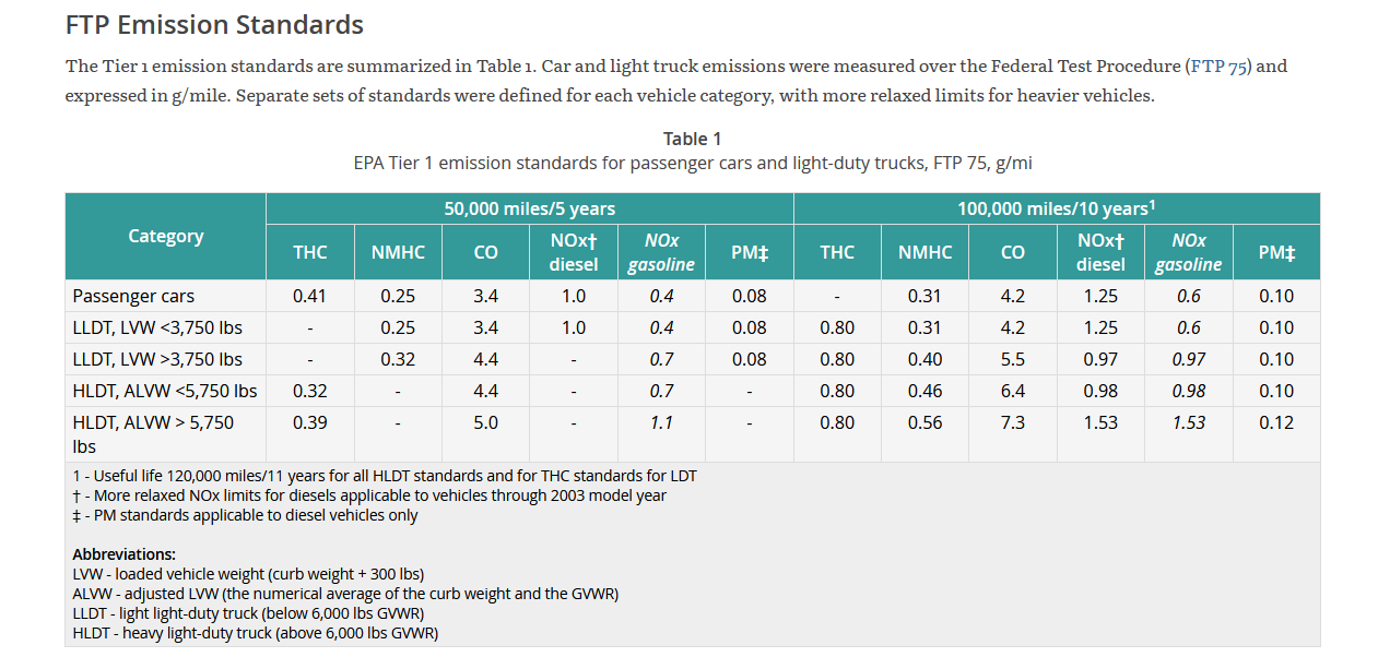

Here are the numbers for Tier 1  "Light heavy duty onroad vehicles"

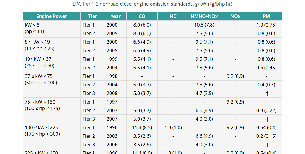

Here is the table for off road engine tier 1
