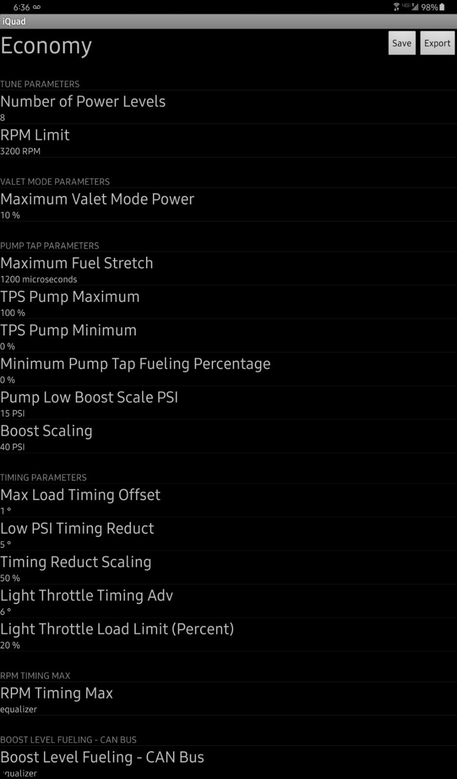

I bumped my Low Load threshold to the max of 40%. Since I have stock injectors I figure that's got to be about the same as a lower load on bigger injectors. My engine sounds better and the fuel economy seems to have improved a lot. Low load cruising boost has dropped. Flat ground driving for me is engine load near 30%!
Stock injectors require long duration of being open to make the same amount of fuel.
@LorenSYou might want to nudge the cruise timing up some more you notice the engine load may drop a bit more. If you notice the rattle is way more pronounced and then engine load seem to climb a bit your at your limits and need to back down again. Here is my latest Economy tune... Cruise timing at +6°...
I've ran the cruise timing at +4° for the last tank barely made 17 MPG. Now jumped up to +6° cruise timing and now the EGT's dropped really good and the engine oil temp rose about 5° roughly. So now I'm advanced about as far as I want to go. The rattle is more pronounced but EGT's are down, boost is down, and engine oil temp rose slightly. MPG appears to be better now and gaining above 19 MPG rough fuel gauge / odometer math.

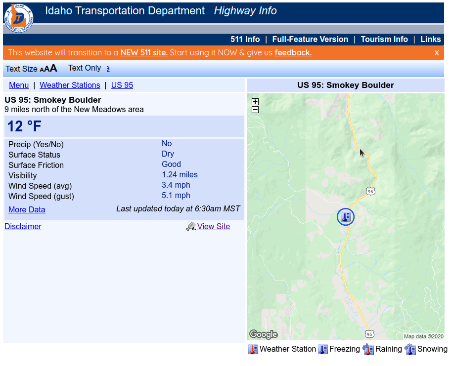

Here is today's weather...
I haven't tapped the pump, but do generally run around in level 3. I haven't tried level 2 with these settings, will likely do so on my next highway long haul.
Do these numbers make sense for HY35 and stock reman injectors (50k miles)? As mentioned above, the truck is smoother, more responsive, boost at cruise has dropped from 5-7 down to 1-3 PSI! Haven't paid attention to IAT, but EGTs dropped some. I don't really see 2500 RPM very often, not sure I've seen 3k - certainly not unloaded.
Start out at 13° at 1,500 RPM and step up +4 or +4.5... Your first step up from 15 to 20 is too wide (+5°) even for my truck.
