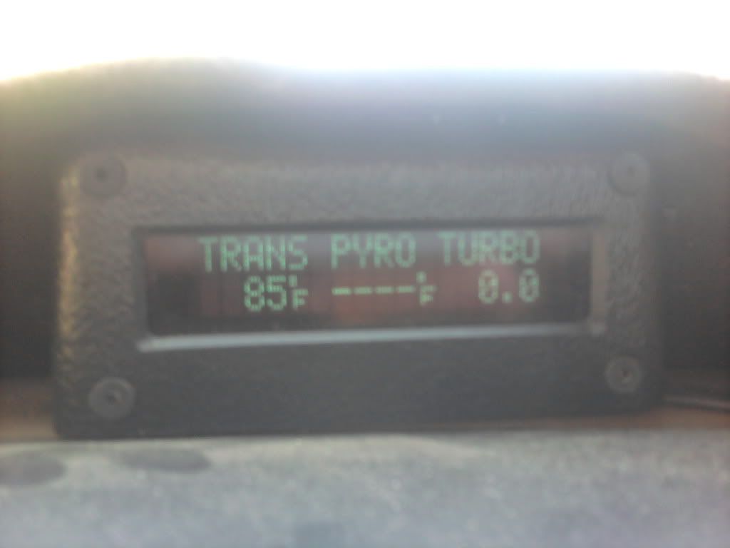

post-11232-138698179817_thumb.jpg Here it is. I was able to get the photo off the hard drive and didn't use photobucket.:hyper:
98white, I was re-reading this and your posts finally sunk in. I do find it interesting you want to move away from your computer as your full gauge display and go to all mechanicals. I think I need to get comfortable with just an A-pillar setup.
I feel that mechanical gauges are more accurate and trouble free and really just like the look of them better. I bought the quad commander years ago for my 03 when I first got into diesels and it was cheaper as a combo with a quadzilla xzilleraider than standalone gauges and a smarty. Had I known what I know now I would have a different settup.

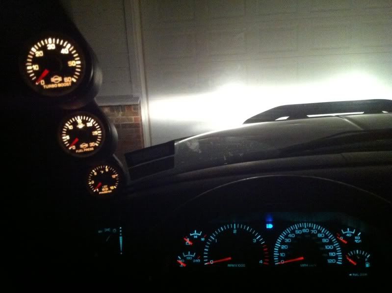

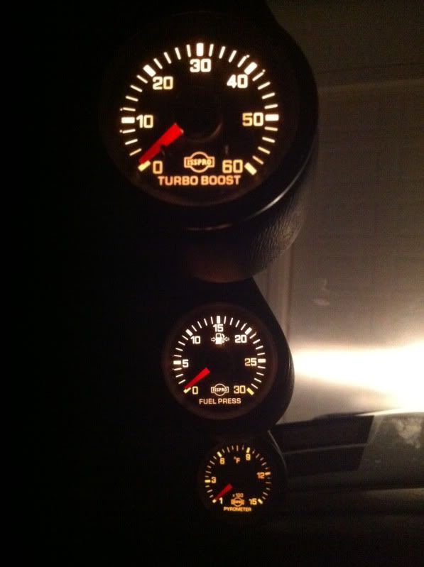

All I have is some night pics of my Isspros, mech fuel pressure gauge as well as boost and pyro. Had these installed in my truck for right around 2 years now and they're still working great! Only have 2 pics and they're not the best quality.
Posted Image
Posted Image
-Jordan-

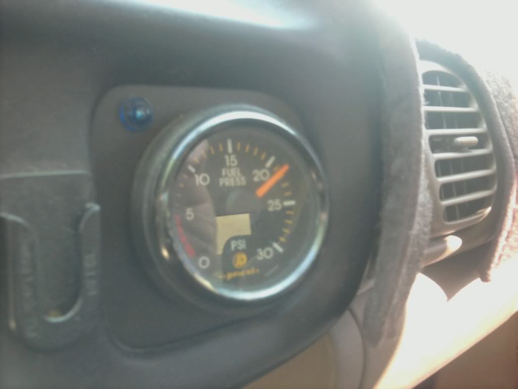

Dripley, I went through Geno's and bought a Isspro EV mechanincal gauge w/islolator, a banjo snubber, vulcan line that makes connecting the isolator to the banjo snubber very easy, Geno's gives you a gauge mount faceplate for the cubby hole free if you buy the gauge from them. It really wasn't hard to hook up. I took out the cup holder (6 screws) it made running the line to the gauge easy and I just hooked the light in the gauge to the light in the cup holder (it dims). Have a new fuel filter on hand as it is a good time to change that if it needs it. I forgot to order a green bulb cover for the gauge and it looks really out of place with a white light.It took me about 3-4 hours. I am slow and am sure others can do it much faster, I am crippled. Have some teflon tape, the yellow is supposed to be for fuel unless someone else has a better idea.The guage comes with good instructions. The bolt on the bottom of the fuel canister is 17mm if memory serves me.Don't forget to close the dump valve on the fuel canister before bumping the starter to prime the system. It makes a real mess. (yes I did)My idling pressure is 7 psiWOT pressure is 3.5 psiI am glad I put the gauge in!The gauge cost 138.00Vulcan line 19.00Banjo Snubber 17.95Total $174.95Guess what I am going to doing soon....
i would say you are going to be putting a new lift pump in very soon or you are going to be putting in a new vp also. that pressure is seriously low. you need to get upwards of 17 idle, 15 wot. i have my AD set at 20 idle, and it drops to 16.5 wot.
