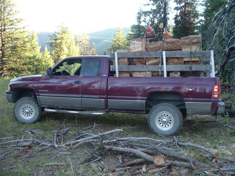

Oh just for fun... Some of the grades around here are really steep!
My truck hauls heavy for a living...
