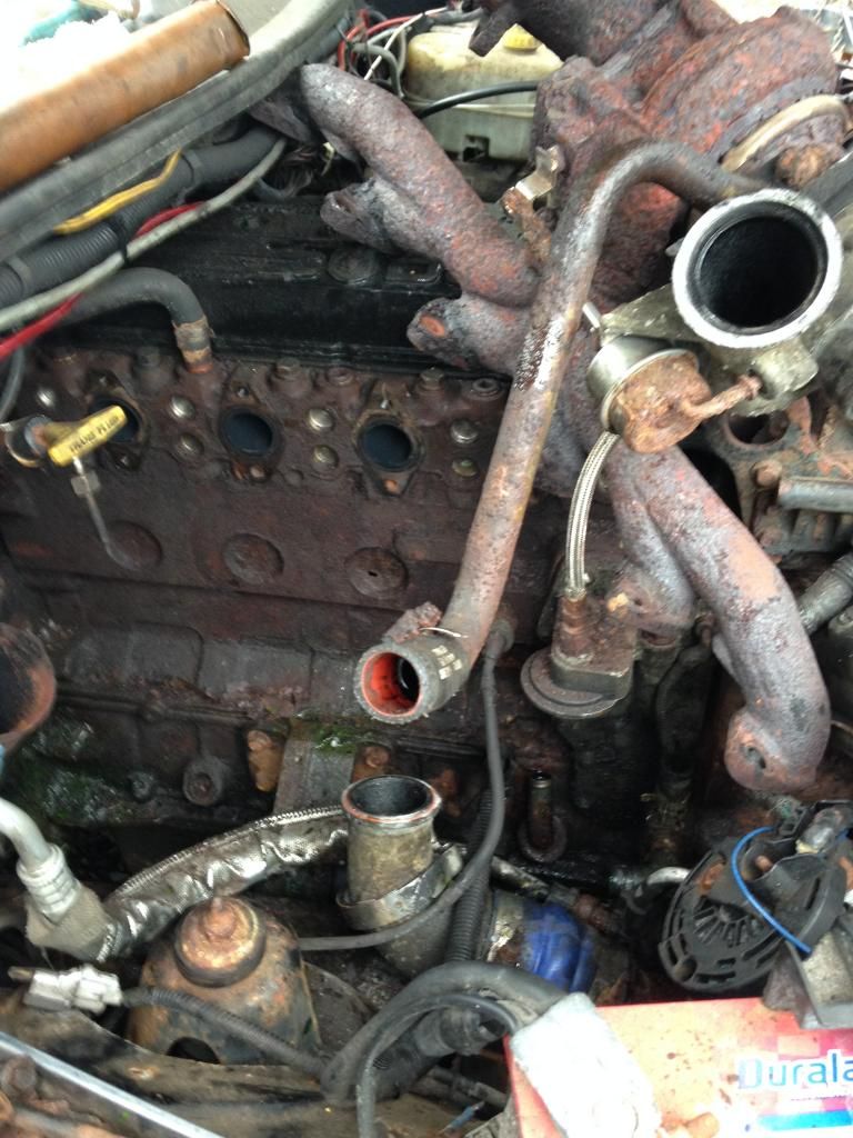

So I got it all out, I pick on the truch when ever I have time everyday
I did see that the turbo drain pipe is on a hose at the motor side it was easy once I got the oil filter off so now all is out of the way manifold is off turbo attached to it and soft feed line is still attach
the auto trans cooler on the side of the block which gets trans fluid and antifreeze running through it is rusted to hell and leaking anti freeze so I am taking that off and running the one cooler on the front of the radiator only
will cap off the lines at the water neck ( where antifreeze feeds and returns to block under radiator )
will also change the one feed line going to the heater core its all rusted and may just break soon on me
here is a couple of pictures I took of what it looks like with stuff out the way
I looped the trans fluid lines under the truck

well,  you could  go and  find a  rust free  gasser...  with a shelled out  5.9  (ahem...  I have  a 'few')   so  keep an eye out,  they're   'out there'      and  swap your   diesel  into.
I have a  94,  that  was   used  on a  golf course,  to spread   fertilizer.  Amazingly,  the body,  or  anything that was  painted is  still in good shape...  that's where  it  ends!
Up until I saw your pics..  I've never  seen  an engine block  like mine!   your  exhaust manifold  looks exactly like  my  360 gas motor!      it's flaking away so bad  some of the  numbers cast into it have disappeared..   when you start the engine,  with hood open,  it  spits  chunks of  rust flake  as  it  heats up!     gotta wear goggles  around this thing...
I won't even mention  my frame rails  (alongside the fuel tank).
My Gawd.
Was that thing buried at sea for the past decade?  I've pulled hundred year old farm implements out of the holler that weren't as rusted as that!
