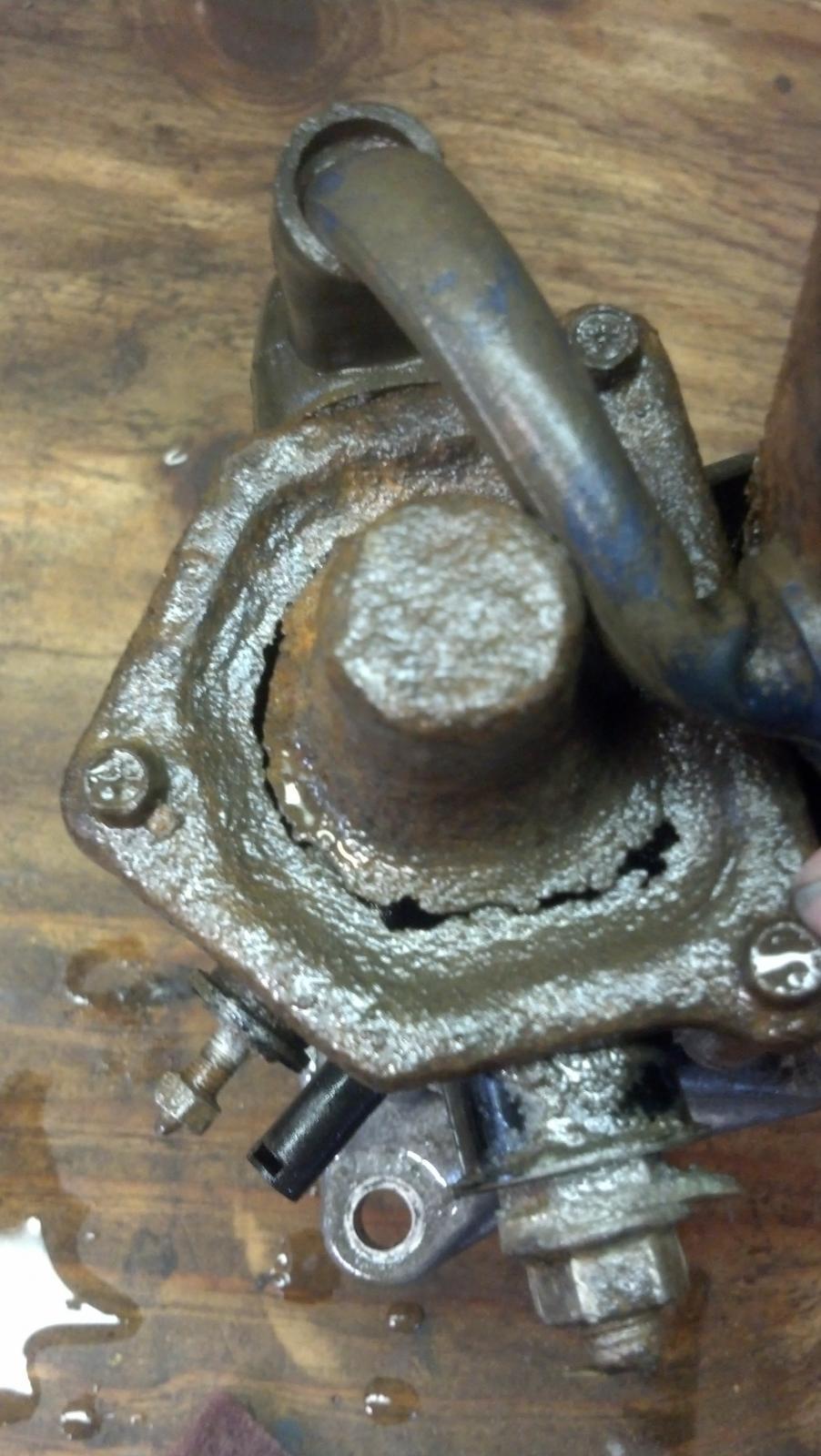

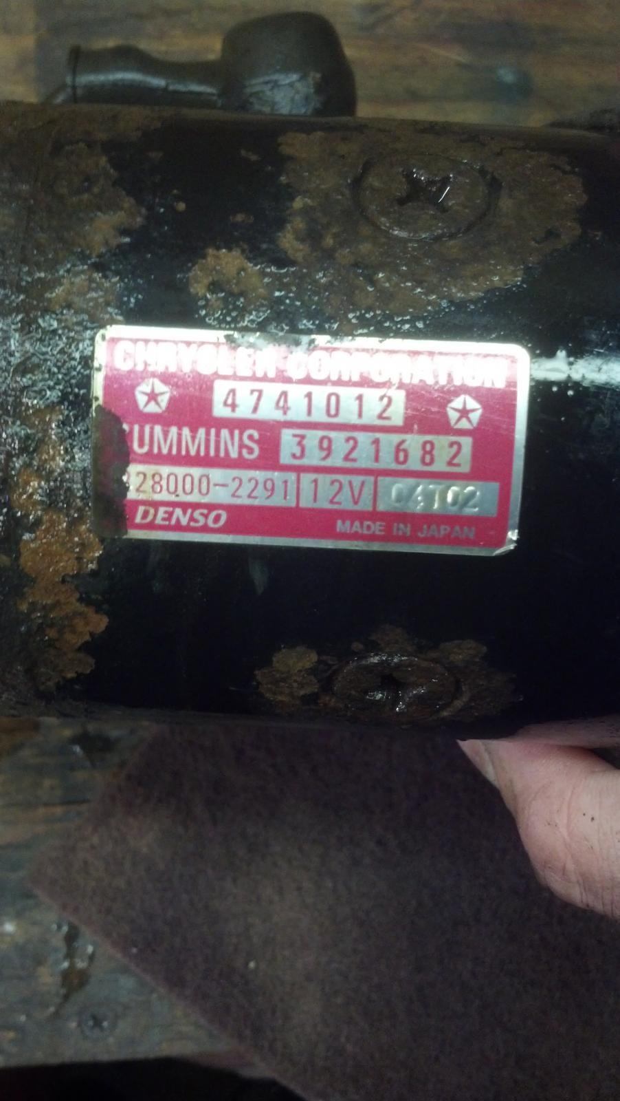

My starter is about to give up the ghost, have to hit the key several times before it will engage. I'm getting power to the starter because I can hear the big click when I turn the key forward. I've had a rebuild kit from Larry for quite some time now, time to dig it out and blow the dust off and put it to use.
is there a website all i can find is ebay and amazon?

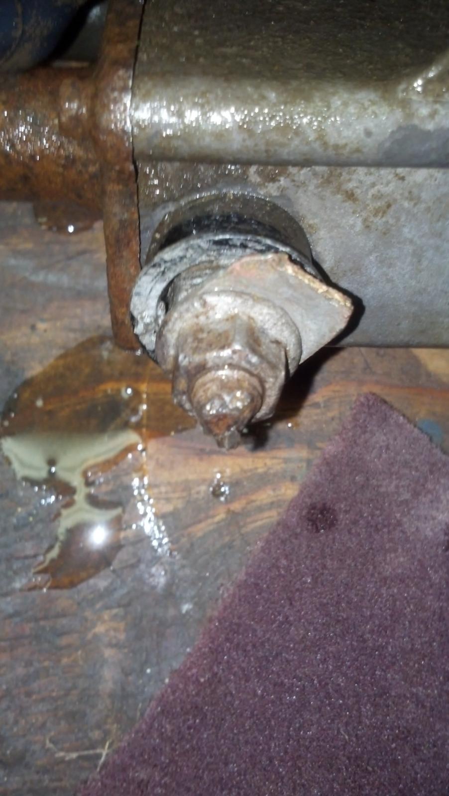

I broke the terminal off myself by bending it back and forth...it was in bad enough condition it needed replaced and the nut was acting like it wanted to strip out so rather than risk rounding the nut I got it out from under the truck and put a little heat on the nut and it came right off.
As for the end cover for the selonoid I cleaned it up with a little spot blaster and coated it with a liquid metal called Belzonia. Very strong 2 part metal filler. I bead blasted the motor casing once I tore everything down and put two good coats of chassis saver high gloss black on. New contacts, plunger and brushes from Larry B's and reassembled and she's good as new. Spins over faster tnan she has in a while.
