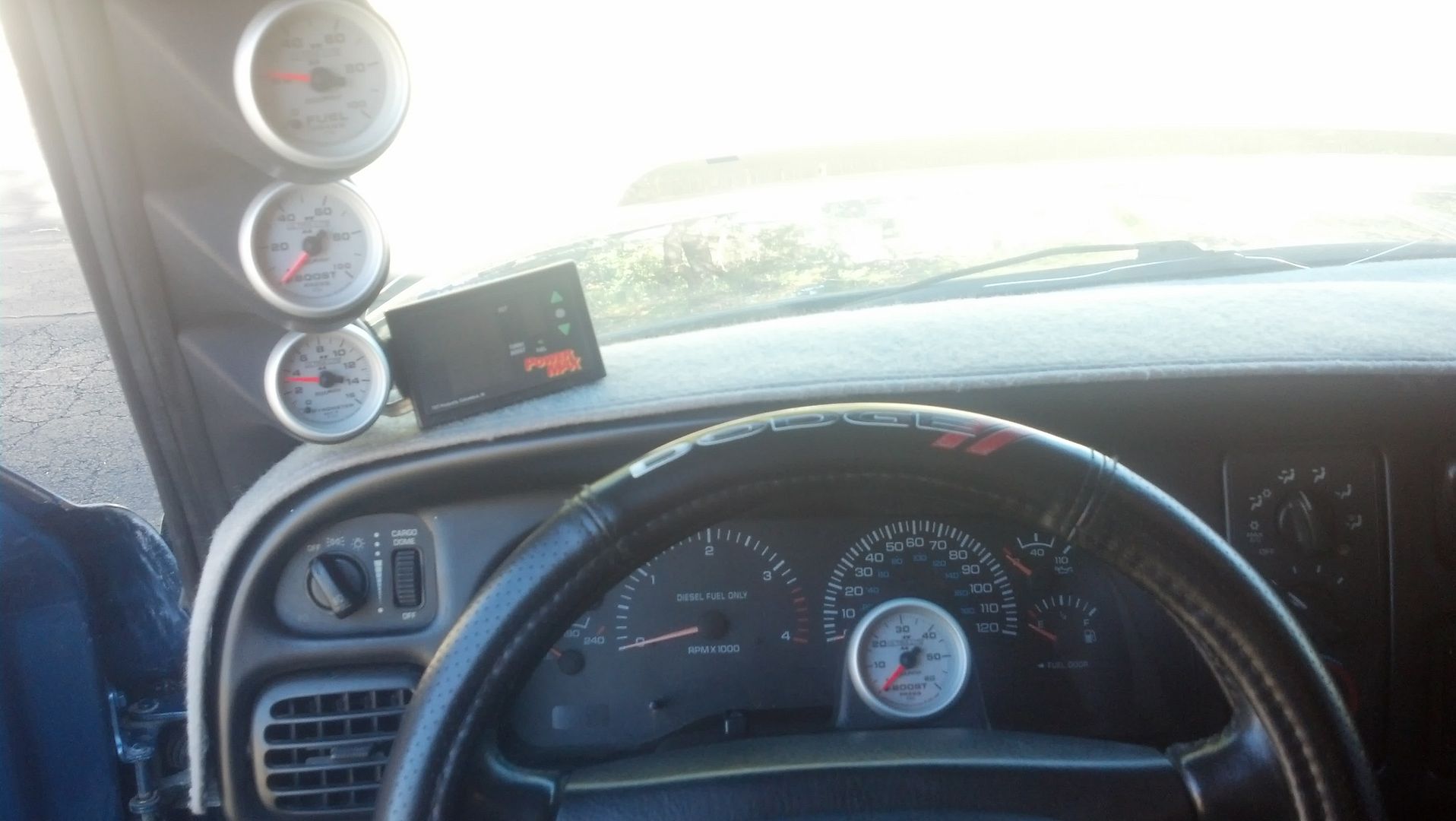

Got the gauge in last night. I'm a little pissed off though. Spent 80 bucks on a 100psi gauge and it's bad. It sticks at 40 unless you hold it at 55psi for a few seconds. Then it'll slam over to 60 then back to 55. O well... I'll get it straightened out this week.
I currently have the boost elbow completely closed off and I'm seeing 20 from the primary and 55 over all. This tells me the drive pressure is pushing the gate open.
Also, I was playing with the tst and I'm seeing 55psi whether the tst is on 9, 7, or even level 3. The power feels the same and the boost is exactly the same. Is this because of the small injectors??

And another gauge is in
Supposedly the gate will open anyway from DP like you said. So going to hard to know when with the elbow closed. I cant see what fuel your running but if your limiting out like that then yeah thats the most likely cause - lack of fuel. Suprised your not driving that primary harder though as its a smaller turbine from memory on what you posted. Id get the secondary to start opening earlier and see if you can push the primary to 25-28 ......

I can open the elbow and see what it does, but I'm betting the gate is wide open from drive pressure already.
For fueling I've got a smarty, TST comp, DAP 125's and a SO VP. Higher tst numbers just give me higher egts. The boost is staying the same.

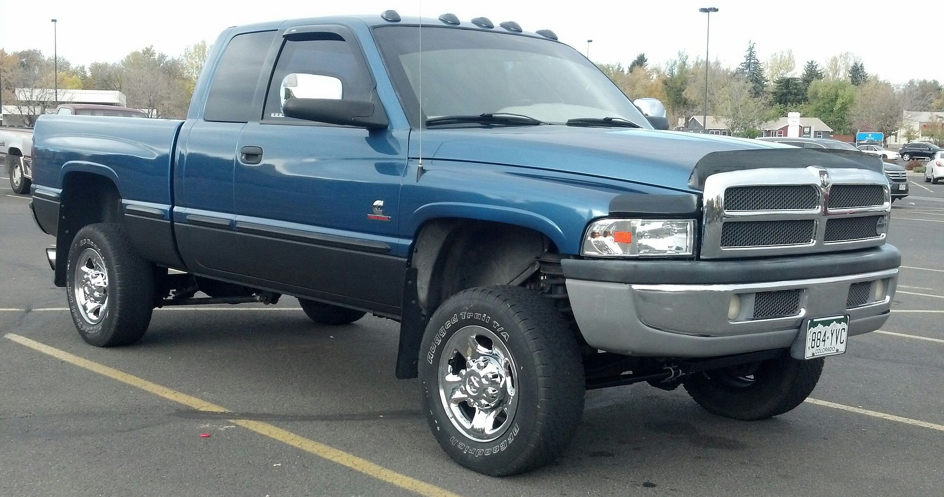

Opened the boost elbow 3/4 of a turn this morning. Primary was pushing 30psi but not sure about overall thanks to the POS gauge in there. Also gave her a wash last night.
IMG_20151101_093431_181-1_zpso55zuu0v.jp
Glad to see you made it to denver :shifty:
Got the tires balanced yesterday!! Hopefully that'll stop the death wobble at 90 :lol: Just have to wait and see I guess!
Bet overall was slightly higher but you should have noticed more pull ...
Then yeah think it's fuel. That setup your running is good for around 500hp ... so 55-60 on twins sounds about right.
