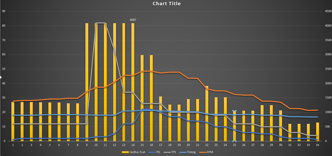

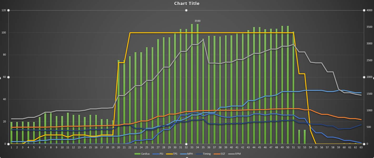

I had some time to drive about 40miles today on the highway.
With stock my timing runs right at 17 running 70mph.
For some reason I get a random blip of 25 degrees of timing and my canbus drops to 0.
