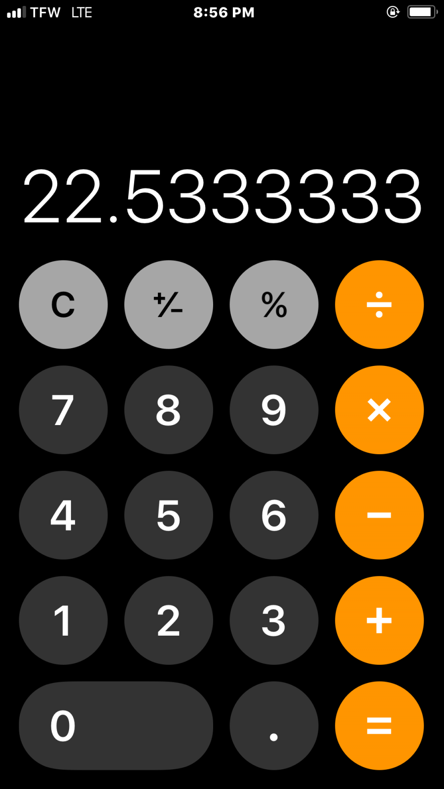

    Finally!!! Yeah!   Broke 21.06 MPG. Finally got the tuning figured out. 297 miles and filled up with 14.096 gallons giving me 21.06 MPG. This is still with winterized #2 diesel and winter co

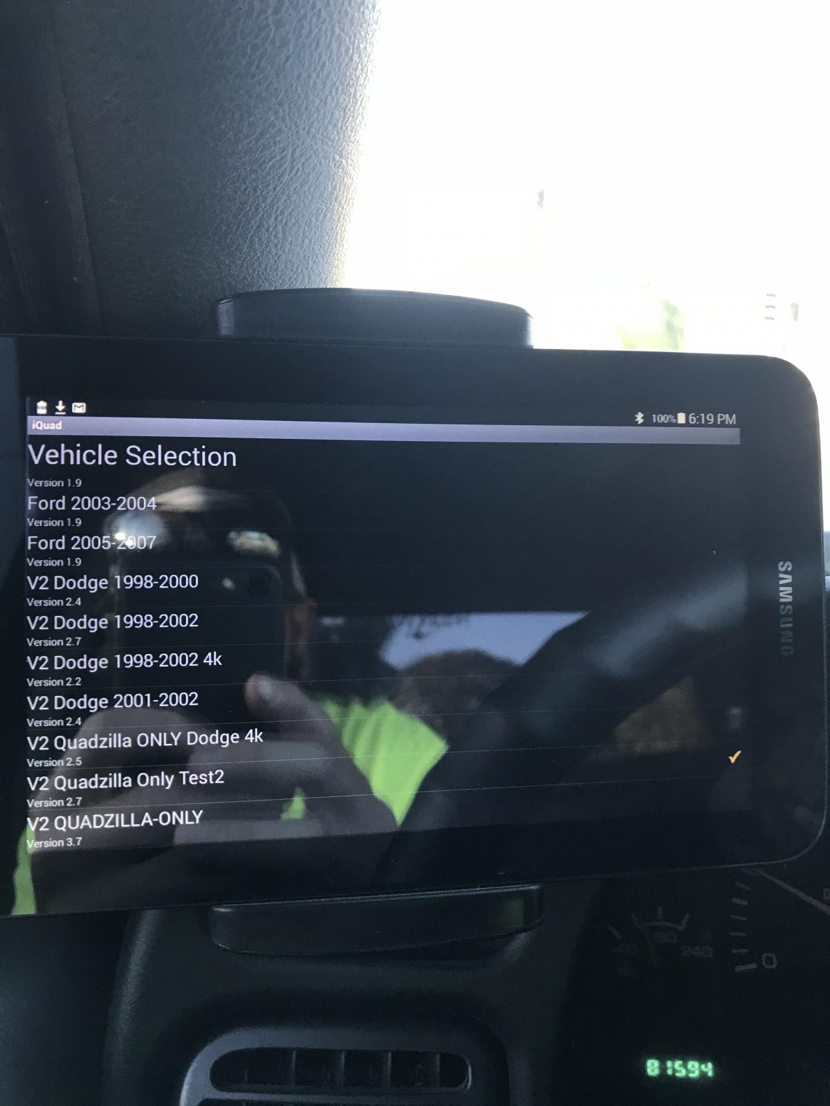

Well if you want data logs you going to have to correct that menu button so I can reach the menu on the fly being I can't just stop on a interstate to do logging nor can I stop in the middle of a two lane road to do logging. I'm still travelling roads with no pullouts so till that menu button is fixed I can't do much being that I might have to drive 15-30 minutes away to a pull out or off ramp by then the little tiny 5 minute log is long gone that I wanted.
Till then you'll have to consider what I'm say... I have no other choice... They still look like this right now. Just better weather, high berms.

That menu button is weird, on my s5 I got what you got @Mopar1973Man tiny icon at top left corner that is hard to access at times. And when I downloaded apk to my s6 that I now use in a truck I got this circle with 3 dots that I can move anywhere on my screen, and it allows me to go to menu.
@Quadzilla Power on samsung s6 I have this circle with 3 dots and it can be moved anywhere on the screen, and on s5 I didn't get that, was it a glitch? Much easier to access menu than tiny one at top left corner. Was there a change in the apk.

I understand what your saying, but I can't fix the app side stuff, that is %100 outside of my control.  Gotta understand I have no dog in that fight, you will have to talk with @Quadzilla Power about it directly, I simply will not remember as I don't have that issue on any of my devices.

all I can say is contact Quad about the app issue and ensure it is on their list.

3 hours ago, Dieselfuture said:
I cannot get these gauges on my iPhone 6. What do I do to get them? I don't have a Quad yet, just tinkering with the iQuad app....seems I am missing something. :(
@Mopar1973Man
Call them.  emails get lost in the vast onslot of stuff that comes in, just like posting them here.
Do you have the unfiltered datalog for the graph you posted?  I need to know the other sensor inputs from that log to know what caused it to kick out of cruise timing.
I got android samsung s6, not sure about apple stuff,  sorry.
Take your finger drag the screen to the left or right.
If all you have is the circle in the middle, you need to swipe up from the bottom of the screen to get access to the gauge palette. Press and hold to select a gauge, then drag it up to the posiiton you want it in.
If you want to change the layout, swipe your finger from right to left to access the other layouts.
