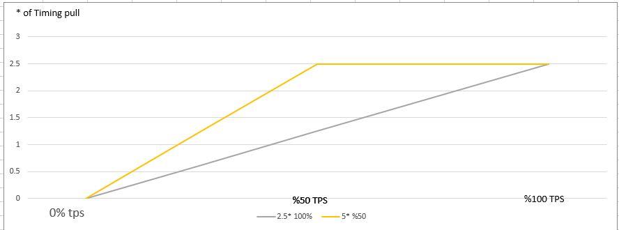

scaling sets a max amount based on the timing reduct
So 5* timing reduct and %50 scaling gives you 2.5* max timing pull.
So 5* timing reduct and %30 sclaing givees you 1.5* max timing pull.
So 5* timing reduct and %70 sclaing givees you 3.5* max timing pull.
The key is how fast timing hits that point. in this example we have 2.5* timing reduct %100 scaling vs 5* timing reduct %50 scaling.  same total pull in timing, but the 5* %50 scaling hits peak timing pull at %50 tps input
