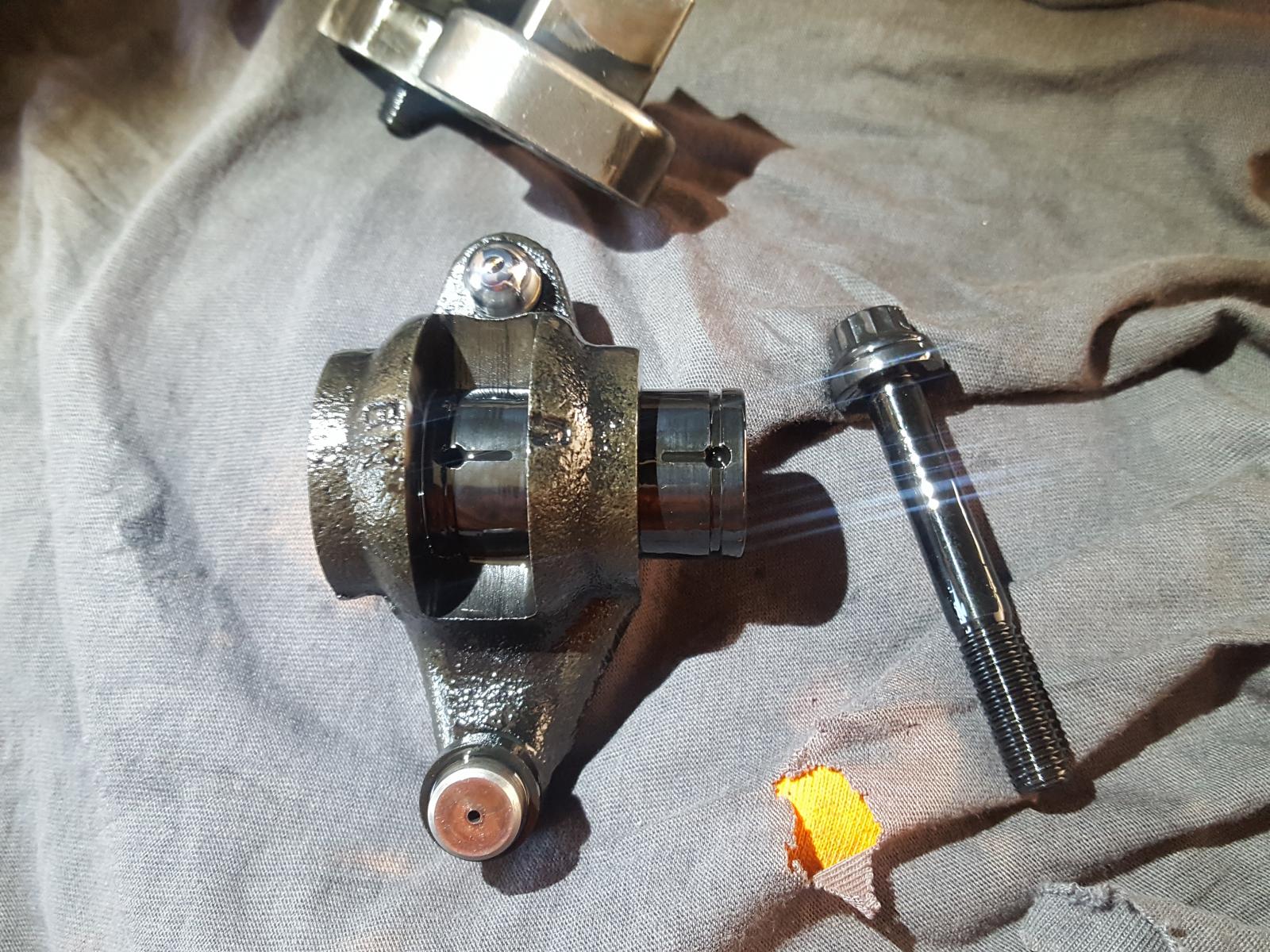

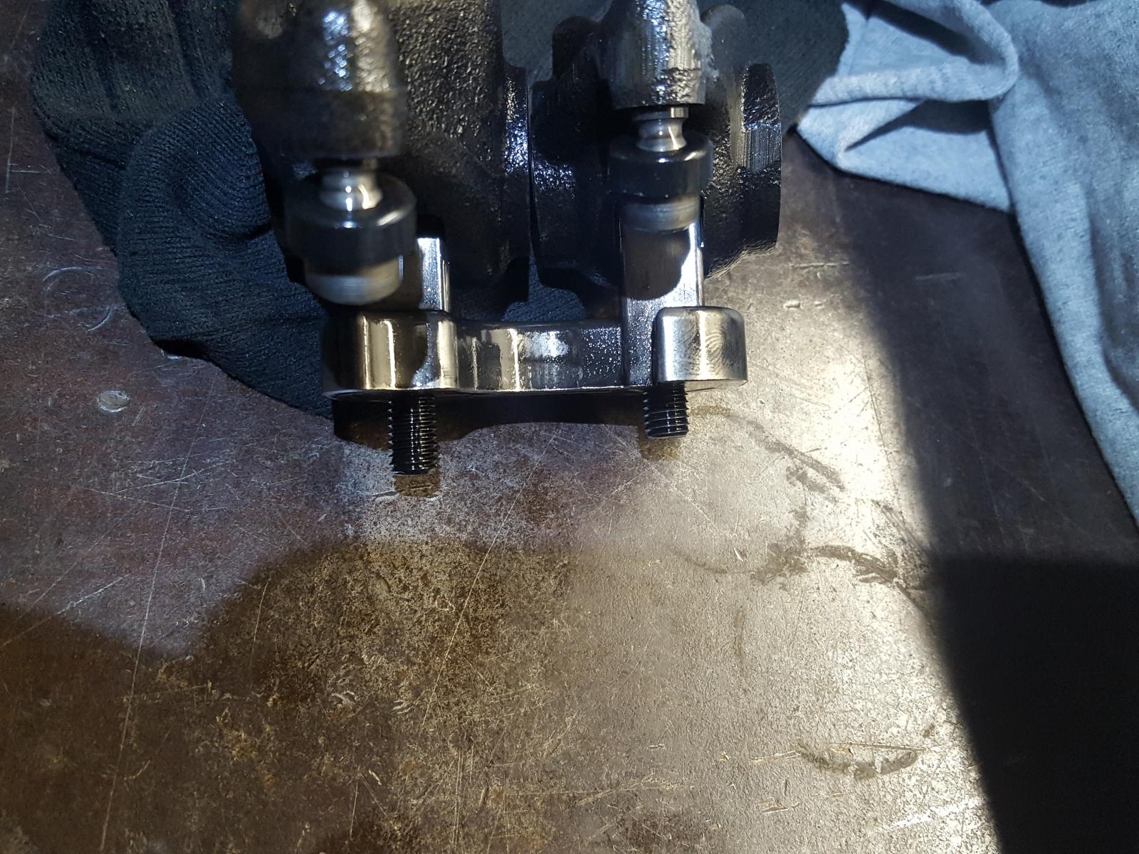

Another thing I might be doing is upgrading to better push rods, springs, trunion bearings and roker arm bridges from Manton. That may explain my ovaled guides and smashed seals, or so I hope.

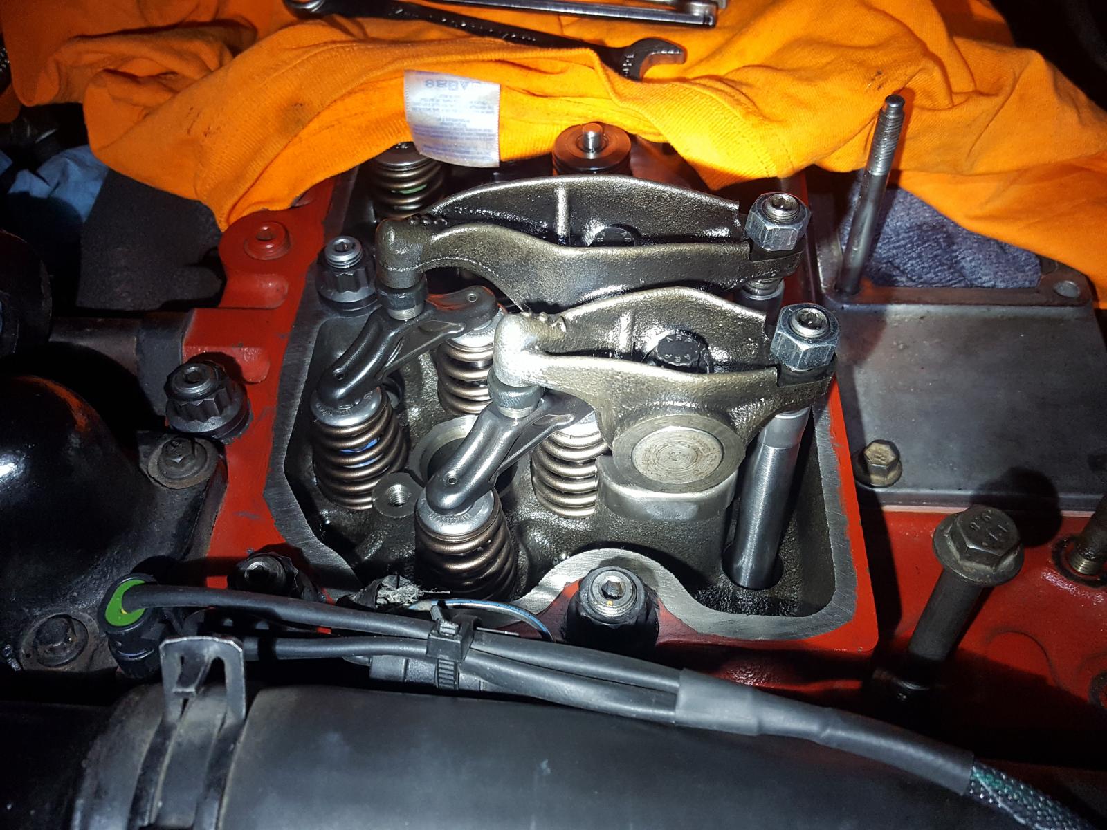

Made a little progress today. Head just has valves left in it, so tomorrow if I get time I'm planning on retorque the head. Then I'll be waiting on seals to show up and few goodies to go along with. First set of seals came in, I got regular ones that look top notch and newer style top hats but that lip is definitely on the way, they do slide on the guide nice and tight and bottom out on the lip. Hopefully other kind will fit, we'll see. Also took 7x10 injectors apart and looks like brand new nozels, not sure what brand but definitely not reworked Bosch. Looks like good quality though. Pulled windshield wiper guts out since I have to replace motor anyway and one push rod didn't come out, it was hitting the swing arm on wiper. I'm also thinking getting some SS 1/4" screen and covering them big holes where windshield wiper motor sits to keep future mice and debris out, here is an injector with about 6k on it, looks a bit carboned up to me in such short time, but this stuff whipped right off with just a rag. 20180810_200039.jpg.0b7fab2047e846d01336861a41582966.jpg20180810_200325.jpg.921e0481bd860e6797e2231f5b2f3c23.jpg20180809_185427.jpg.084e8241fac98d0bf62f691fd8f36328.jpg

This is some quality stuff here, the only problem I'm seeing if it's even a problem is springs fit very tight in a hole. But they do fit, I'm waiting on reply from Trevor. He said not all Cummins heads were identical and he'll check tomorrow when he goes to work. I'm probably over thinking it but want to be safe. So far I got 12 1/2" push rods, 24 springs and 48 keepers, 5 bridges lol, and set of arp bolts to hold trunions. Trunions didn't show and missing 7 bridges once again lol but a little but hurt.
And I also got these other seals with a lip, they are ready close but with few issues that I see, that may be delt with. The OD is bigger at bottom which I shaved not a concern, overall height is ok, the only thing is where it presses on guide is tight and needs light shaving. I'll play with it some more when I get more time. Overall seals are doable but with modification so not sure if this is going to be for everyone. In picture you can see I shaved rubber f most bottom lip for the lip on the head but that didn't need to be done the hung up was on guide itself. This is kinda hard to explain but if you were looking at it it would make sense. One other thing I noticed on seals is original has 2 lips to ride on valve and the on I'm trying to make work has one.
In assembled picture seal is in place.
Picture with seals, on on left is tophat if you machine the lip off, using it for diameter on base, middle is the one I shaved and right is the one that needs shaving.

So after long discussions with multiple people I've decided to give these springs a go. Now to be clear these springs are conical design and not beehive. It's somewhat new in diesel world from what I understand but been around in gas motors for a while. They are harder to produce and that's where the cost comes in. In my case I probably don't need them but I was going to get some springs ether way and I got a good deal so I'm not out too much more, as long as everything works out and it should. Same thing goes for pushrods I was looking for a 3/8 set but once again got a good deal on 1/2" and from understanding it's better all around. Trunions were galled up and weren't going to get better and adding extra load from heavier springs will make it worse I'm sure, so why not it's only money right. And that goes for bridges, since I had experienced premature guide wear I decided to stiffen things up, maybe I am harder on my truck then I thought.
So if it all plans out, I'm hoping the only thing I'll be taking valve cover off is to adjust valves.
Almost forgot I did finally fit the seal and it seems to be good, good chance I'll be using them. In the picture you can see I grounded down OD of base on both seals and shaved a bit of rubber where it slips over guide on one, you can see darker portion on bottom where it pressed over guide. So we'll see if guess.
I used 31/64th drill bit in reverse to shave rubber 1/2 may be ok but not sure yet.
Edited by Dieselfuture
Got seals and springs installed. I used top hats on exhaust side and regular on intakes as all of intake seals were not damaged. On top hat seal there is only one lip that rides on a valve and that is so it wipes more oil, since these seals are from a gasser EPA doesn’t want gasses to use any oil. So what I did is removed the little spring that holds tension to valve stem.
