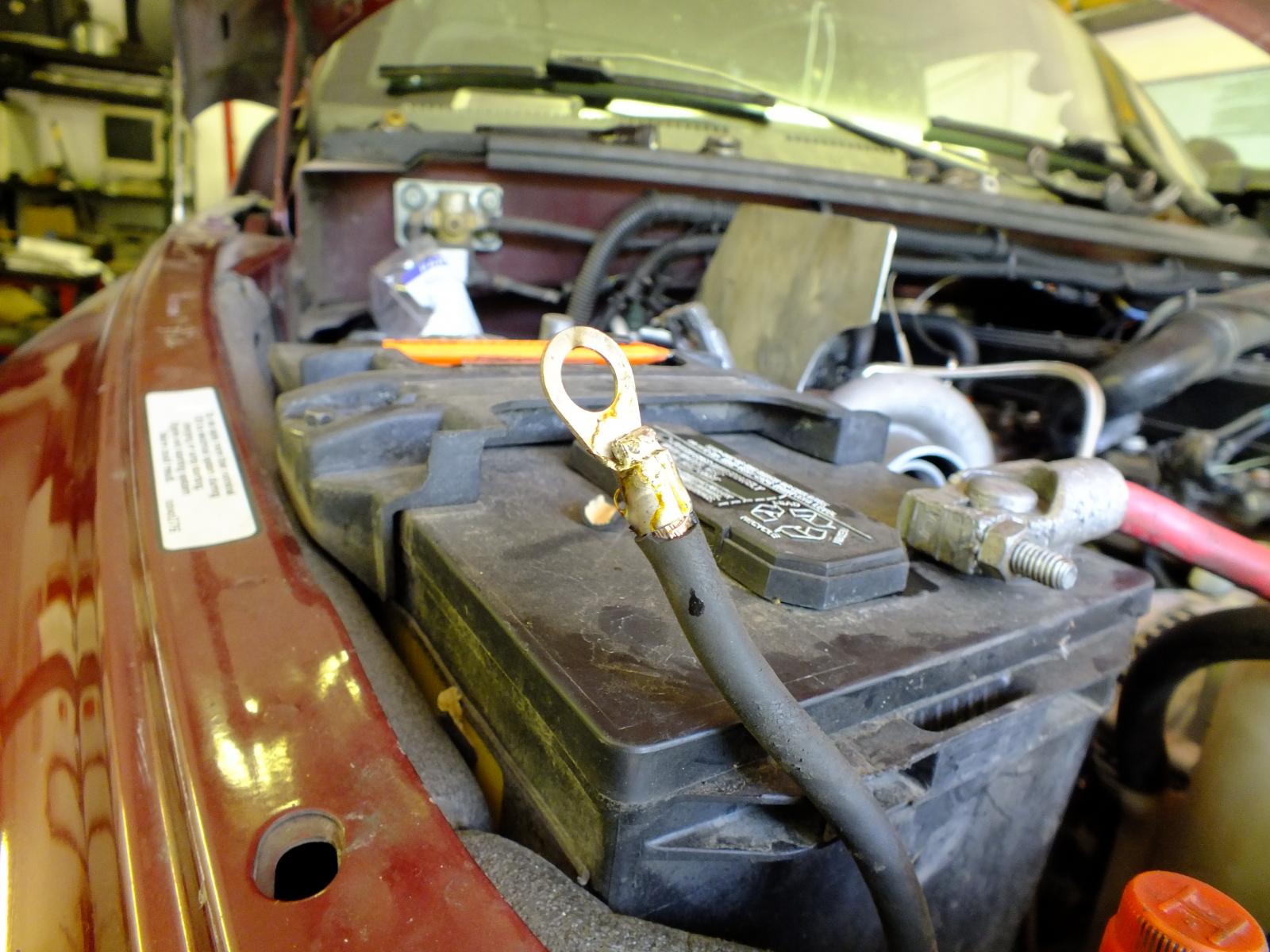

Are you using an electric soldering gun? What is the wattage?  The joint in the photo looks like it needs more heat.  Try adding some flux and more heat to the one in the photo  and see if you can get the solder to flow using the procedure below.
When soldering, hold the tip of the soldering gun against the crimped terminal.  The heat will transfer through the crimp into the wires.  Touch the solder at a point where the terminal edge meets the wires.  When the terminal and wires get hot enough, the solder will start flowing.  Keep the soldering gun tip on the crimped terminal and keep adding solder as it disappears through the crimp following the wire strands up to the insulation.
Watch a couple of soldering videos on You Tube and do some testing until you get it right.
As far terminal ends - personally I don't like insulated terminal ends because they are too difficult to crimp properly.  I do what you did, but before crimping the terminal onto the wire, I place the proper size of heat shrink with sealant over the wire and push it out of the way.  I then crimp the wire into a bare terminal end as you did (except that I will crimp it correctly) and solder the joint.  After the joint cools, I move the heat shrink into position and finish the job.

Thanks guys. I am using a soldering iron, not sure of wattage..but I was definitely doing it wrong, by just touching iron to solder and dipping and spreading.
I now know what you meant about crimping, I think. You crimp opposite of the split on the inlet. I didn't understand what you meant, because mine weren't flat.
I'll go buy some flux, didn't know what this was..but do now and that definitely seems necessary.
I'm assuming if I apply iron to crimp box, that once the terminal and wires are properly heated, when I touch solder to the wires, it'll travel towards the heat, into the inlet crimp, where heat is being supplied?
I hope my iron gets hot enough..I think it's like 30 watts? It's a cheap one if I recall
Well, I went to get some flux, ended up buying a 60w iron kit for 15$ more tart came with it..let it sit on a test terminal for like 5 minutes..still wasn't hot enough to melt solder. The thing claims to get 1300 degrees..the metal on it turned blue..I could feel the wire was definitely heated through the rubber case..but wouldn't melt solder. I'm pretty skeptical about space and hazard of firing a torch in the engine bay..but I just don't know why I can't get this to work heh.
Will the solder melt on the tip of the iron? You only need about 400* to melt it, IIRC. A plumbers torch deep in the engine bay is not a good thing. The pencil torch puts out the same type of flame only much smaller. Still have to be careful where you point it.
