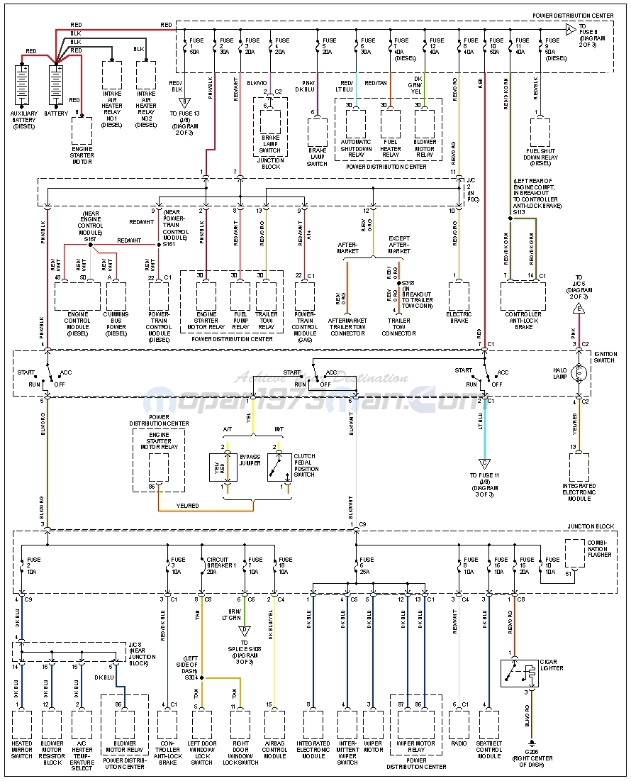

First, let's make sure are talking about the same fuse locations.  My FSM is for a 2002 truck, so fuse locations could be different than yours.  Is your PDC (Power Distribution Center with fuses and relays) under the hood beside the left battery?   Is the Junction Block (another fuse distribution center) on the left side of your dash with a removable cover and only visible when the driver's door is open?  If both of these are true, then we have the same setup for the most part.  Next question, is fuse #12 (IOD) in the Junction Block?  If so, look at the wiring diagram below to count how many components are powered by this fuse - you will see plenty.  You could have something as simple as a glove box light staying on and you would never know it.
2 hours ago, Ryan Daugherty said:
I followed steps of disconnecting both battery nagatives and hooked up test light,which of course test light came on bright. Started pulling fuses, first fuse I pulled was #12 IOD fuse 10a. Found that fuse #12 made light go very dim.
Looking at the diagram below shows that there are several electronic devices or switches that operate lights downstream of Fuse 12 (IOD).  This is why your test light is bright when the fuse is in place.  The test light is a fixed load with a specific amount of resistance.  The test light by itself does not tell you how much current is flowing (amps).  This is why the multi-meter with a 10 amp current testing capability is needed and is used in conjunction with the test light.  One thing you can do is make sure that things like the dome light, vanity light, glove box light, under hood light, etc. are off.
